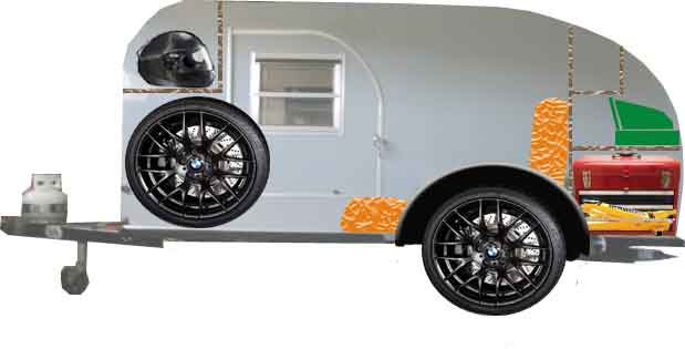

Postby Martiangod » Tue Feb 28, 2012 8:34 am
Or a Benroy plan, build 5 x 8, Rack tires across front so when you get to event pull them out, futon type mattress would then fold down for bed.
Keep galley area to a min so you can carry tool box, jack and stuff. Make front cubby deep enuff for helmet, gloves, fire shoes and the sort.
Get Beemer bolt pattern so you can run same tire as car, no spare to carry then
