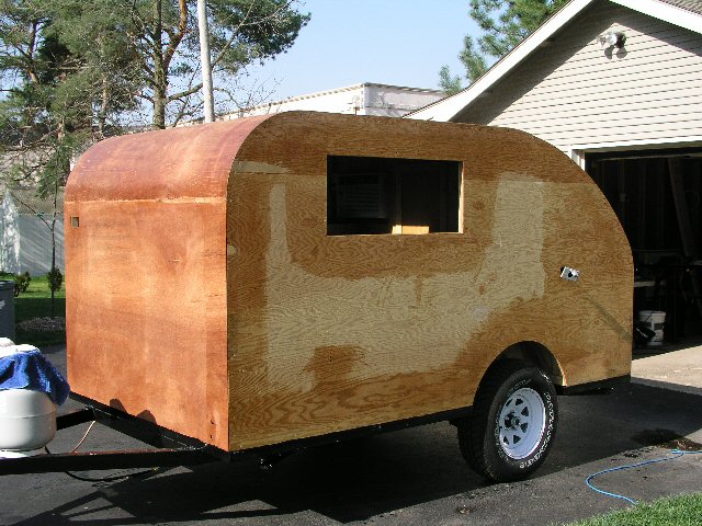

I just put a coat of CPES (Clear Penetrating Epoxy Sealer) on the parts of my tear that are done. Of course, I saved some for the parts that I haven't built yet.
I'll have a picture later.
I'd like the get the holes puttied up and get the first coat of white on it by Sunday afternoon. Weather permitting!
Postby mikeschn » Wed Apr 28, 2004 5:53 pm
Okay here's a picture of the tear with some CPES on it. I ran out and decided not to put any cpes in the middle areas where there is the least chance of getting water. Of course, I do have another can in the garage, and if there is any left after doing the hatch, then I'll come back and hit this area.
P.S. Doesn't look like I'll get any white paint on this weekend if I have to finish the hatch first.

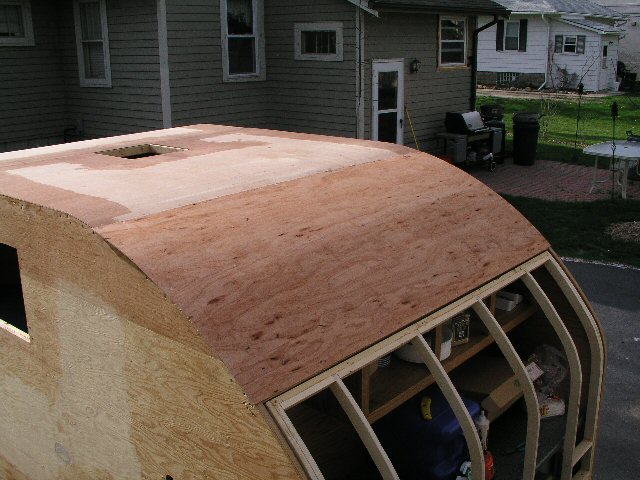

Postby mikeschn » Thu Apr 29, 2004 5:07 pm
Woo hoo!!!
I got the last section of roof insulated and skinned. Whew! The hatch is the only major component left that needs skinning! We might do that this weekend in the basement, since it'll be raining all weekend, or so they say.
Anyways, here's the picture. I still need to use the flush trim bit on it, but that'll be another day.
