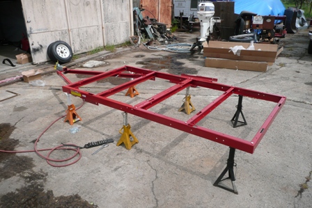

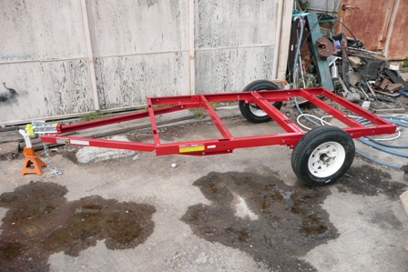

Ok today I pulled the trigger and bought my trailer.
Harbor Freight had the 1700 lb capacity 4x8 on sale for $299 and with my 15% off coupon I got it out the door for $278

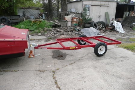

Assembled the trailer and it was a higher off the ground than I thought it would be so the first order of business was to lower the whole thing 2 inches. Trailer was also longer than I really wanted so I cut 12 inches off the back. Also with the shorter trailer I should not have to relocate the rear wheels.
I still have to finish making the trailer hitch for my Charger. I couldn't get the right material for it today so I'll see about getting it during the week.
Before I finalize my design I have to get the ride hight correct so I don't make the tear taller than my Charger.
Found a Aluminum shop today and current price for a 4x8 sheet of aluminum is $45 at the moment. The mirror like aluminum is $190 for a 4x8 sheet :shock:
Here are some pics
Trailer lowered but not shortened yet
Trailer shorted 1 foot in the rear
I don't really like all of the bolts in the trailer especially on the top where the floor is going to be attached, also the bolts down the side where the wheels are mounted. I think I'm going to weld most of this trailer together and take the bolts out of it. There are also the pins you can pull so the trailer can tilt, yeah thats gona get welded too.
Don't get me wrong, this is a very good trailer and I love the fact it came in two boxes small enough that I stuffed it in the back of my PT Cruiser. I just can't leave anything alone and love to screw it up my own way. I promise you if nothing else this will be a very entertaining build and one of a kind.
Probably should start a new section called "How not to build a Teardrop"
I also need to figure out how to get a fatter rim and tire to fit.
I'm thinking adapter or spacer with longer studs or cut and stretch the axle.

Postby doug hodder » Sun Mar 30, 2008 12:27 am
Steve..I haven't bought anodized aluminum for a tear, I'm doing epoxy and paint, not much in aluminum skin,...is that Cardo's price? If it is a skin..he can get it to you in thin material, thinking like .032 in a bright anodized. Who knows what the market is doing nowadays anyway.
Nice start, yer blowin' and goin'...PS, what's the scoop on the outboard on the rack in one of your pics? Looks sort of like an old Merc. Didn't mean to change subjects, but it is of interest to me, not a buyer, but it is still interesting.
Good luck on your build...and you might want to attend the Dam Gathering at Lake Shasta the first weekend of May...lots of good ideas and about 65+ trailers, great eats and people. It's a perfect opportunity to check out a lot of profiles, ideas etc... Doug

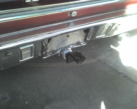

Postby chgrsteve67 » Sun Apr 06, 2008 10:36 pm
Well I didn't technically get any work done on the teardrop.

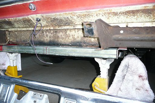

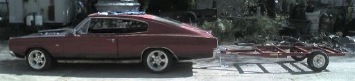

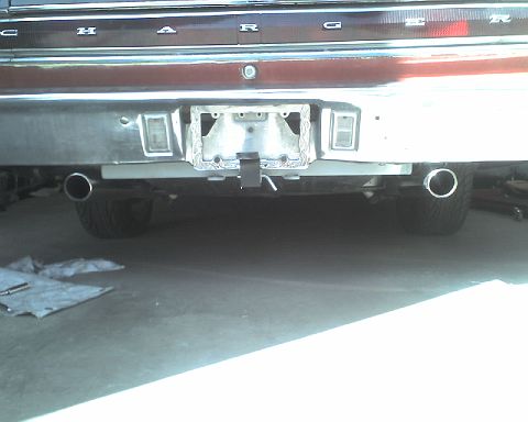

Tore the bumper off the Charger to begin building the trailer hitch, broke two of the 18 bolts, not bad since they haven't been off the car in 41 years. Got the mounts made and the square tube cut then the Fuel Injection programmer showed up (around 2:30pm) and worked on the car until 6pm, getting the VE tables (fuel mixture) correct took longer than expected.
Got the hitch finished Sunday (With the help of my Uncle - can't take all of the credit). Of course we had to run out of gas then not 5 minutes later wire, lost about 2 hours getting the welder going again. Just primered the hitch for now, thinking about having it powder coated. Still need to wire the plug for the trailer.
Bumper needs straightening and re-chromed.
Hoping to get some plywood to get the tear shape worked out next weekend and the doors disassembled.

Postby doug hodder » Sun Apr 06, 2008 10:40 pm
Congrats on a clean hitch install!!! Nice job...Doug
Postby Oregonian » Thu Apr 10, 2008 7:16 pm
Great looking charger and trailer hitch. Just remember when you start your TV up in the morning and the trailer is hooked up, the condinsation is going to be all over the front of the trailer and it will get worse. :cry: On my Jeep, I put the curved tail pipe extentions on and it made a world of difference. :lol: Even if you put those type of tips on just for pulling your tear, it will keep you from having to clean it every time you stop at a gathering.

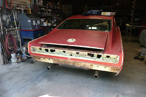

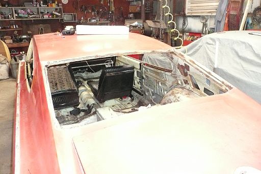

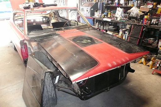

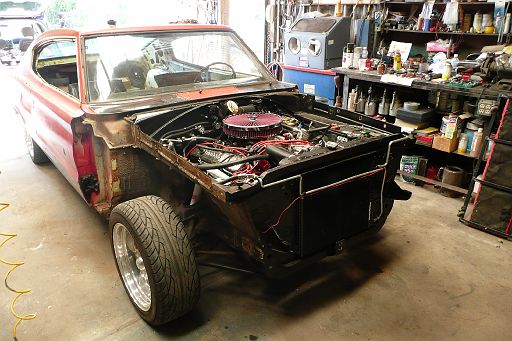

Postby chgrsteve67 » Sun Apr 27, 2008 11:44 pm
Sorry I don't have any progress to report on the tear drop.
Been working on tearing down the Charger for media blasting, I'm kinda hoping the media blasting takes a bit so I can do some work on the TD.
Here are a few pics of what I have been doing.

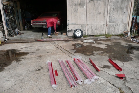

Postby chgrsteve67 » Sun May 11, 2008 11:46 am
Got my Charger loaded up and off tot he media blaster.
Bye Bye for a few weeks.
Finally got some time to work on the tear drop.
Main shape has been decided, what do you think.
I still have sanding to do on the shape to smooth a few areas out.
I still need to take the trailer down and get it registered.
Going to see this week how much some 1 inch steel square tubing will cost.
Also need to figure out what size and shape fenders are going to go on her.

Postby toypusher » Sun May 11, 2008 1:17 pm
Steve,
Nice looking profile!! :thumbsup:
You should check with Grant for fenders that fit the 12" wheels. http://www.lilbear.teardrops.net/parts3.html#fenders
