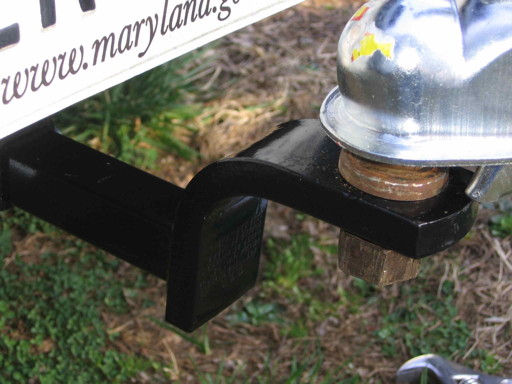

The question that I have is that the trailer seems to be too high in the front and too low in the back and I think that the ball on my hitch is on upside down. Am I thinking correctly on this? I don't want to bottom out the back end, and I also want the weight distributed correctly.
Any advice is gratefully accepted.
Thanks in advance.
Jenn

It looks like it you take the ball off the ball mount, turn the ball mount upside down in the receiver and re-install the ball your trailer will be much more level. Hard to tell from the pictures but it looks like you will get about a 4" drop.
I have mine mounted like you currently do but my trailer is much higher than yours.

planovet wrote:It looks like it you take the ball off the ball mount, turn the ball mount upside down in the receiver and re-install the ball your trailer will be much more level. Hard to tell from the pictures but it looks like you will get about a 4" drop.
plus the 4" rise that it has now dropping the hitch about 8inches....

Yeah... you need a lower ball mount height. As planovet said, I bet you will get just about the height you need by flipping it over. If it's not riding level, you may need to spend $20 on a new one that will get it to the right height... but you will probably be fine just flipping.
Trailers riding "up" of level like yours is currently are harder to control and have more sway, I've heard.

no no no nooooo..don't flip it over..it will be too low..get a new hitch that comes straight out the receiver tube and you'll be ok..
and the other thing is, your car sits low to the ground, so you might want the trailer nose up to keep from dragging the chains.

When I needed to get my receiver hitch I went to Northern Tool. They let me take outside different receivers with different drops to try. This allowed me to make sure i was getting the correct one to ensure my trailer was level.

Using the carpenter adage, "measure twice, cut once" I suggest you might want to measure where the level position is on the trailer and the difference to the ball height with the trailer attached. Then get the hitch bar that gets you the closest.

Jiminsav wrote:no no no nooooo..don't flip it over..it will be too low.
Yeah no doubt. I agree with Jiminsav. 4 inches up then reversed is 8 total. That's far more than I'm seeing necessary in the picture. Why not take the guess work out of it and just get an adjustable hitch? They're great. I've had one for years and it really makes life easier. I have two trailers of varying height so it's a godsend, and it would be great if you use multiple tow vehicles of varying height too. I have a Jeep with a 4 inch lift kit and 33's so it sits pretty high. I'm sure whatever other vehicle I might tow with will be much lower, but with an adjustable hitch, the trailer will always be level.

Get out the tape measure. Level the trailer and measure from level ground into the cup. slide in a ball mount and drop the ball in now measure to the top of the ball. You are trying to match the trailer measurement as close as possible while level.
Mounts are designed in 2" increments a 2" is 2" up or 2 " down and a 4" the same and a 6" and an 8" . Get as close as possible to level then when loaded you will be slightly nose down. You want to be slightly nosed down. Nose up make for some nasty handling largely due to the loss of tongue weight.

Even a 2" drop was too much for my td so I went with a "no rise", like Jim mentioned.
Worked perfect.
Saved the 2" drop for towing my Scotty.

So from what I'm reading it's "okay" to mount the hitch "upside" down ... when I mount like this it's much more level.
