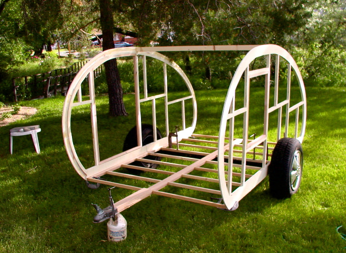

Postby len19070 » Mon Jan 25, 2010 6:02 am
Some people have considered, or have built on a frame like this,
I wouldn't consider a build on a frame like this to be a "wooden frame", but there would be a lot of structurally important wood on it.

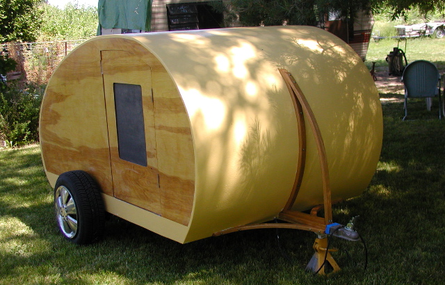

Postby dwgriff1 » Mon Jan 25, 2010 7:45 am
You can build a wood frame successfully, and you can build frameless successfully (all current automobiles I know of are frameless), BUT you have to pay attention to details and you have to know what you are doing.
My build has gone through 4 seasons I think (time goes quickly, so I must be having fun).
It is going into the shop for some updating and refurbishing, but with a great deal of use and a good bit of abuse there is no sign of any failure on the structure.
The trailer is quite light however (580), so less stress is put on the frame members.

Postby dwgriff1 » Mon Jan 25, 2010 9:26 pm
d_lairson wrote:Dave,
What wood did you build your frame out of? Where did you get your wheels/axle? The plans that I was reading just assumed that one would know the right kind of wood and easily be able to get an axle...
Most of the long members were glued up oak. The center piece goes in one glue up from the tongue to the back. The cross pieces were joined with stub tennons.
I have thought about Andrew's ultra light chassis, but on this build the tongue would be too high and I don't know of any drop receiver for the hitch style I have.
The axle was a #8 Torflex, sprung for 800 pounds. The wheels are what my tire guy call "snow tire wheels" that are bored for 5 100 as well as 5 4 3/4. I wanted to use the same wheels as TV, 5/100, but the central hole for the TV is much smaller than the Torflex, and I did not have a good way to make the hole larger.
