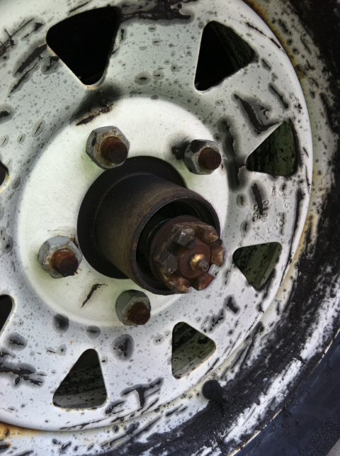

We were driving down the highway at a safe speed, 65 mph, just outside of St. Louis. We heard a couple strange clunks when we went over a bump. We didn't think much of it though.
But we had to stop for gas anyways, so after gassing up, we walked around the trailer to see if there were any problems. That's when we noticed grease splattered all over the rim. Closer inspection revealed that the wheel bearing and cover were missing.

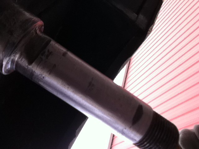

They pulled everything apart, and the axle has a huge groove underneath, where the wheel was riding metal on metal. And the lip where the seal sits is worn away as well.
So we need a new axle.

In the past I have been faced with the same situation. I cleaned the axle area with the groove with some spray brake cleaner, then JB welded the area so the seal had a surface to ride on that would keep most of the grease in. If you are careful and keep your JB weld very smooth it will get you home just fine. If you could get a "speedy" sleeve to put over the JB Weld it would be permanent. Most spindels are replaceable without replacing the whole axle.

Any damage to stub axle need to be REPLACED.... I would not attempt any "patch' other then to get home....
I personally would not use any patches like JB WELD ( although its pretty good in a lot of applications) I would opt for new axle or at least new stub....

Naw you don't need a new axle, you need a farm mechanic.
If the damage is on the axle where the lip of the seal rides there are things called a "Speedy Sleeve" That can restore the lip area on the axle. I have used these things on tractor crankshafts. They are a bit softer than the shaft but hey, so what if it only lasts about 1000, hours. Hell of a lot better than pulling the motor out to replace the crankshaft.

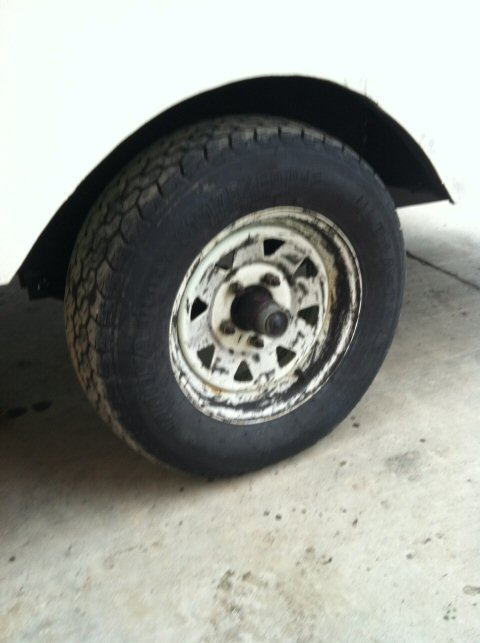

Here is the sight that we saw walking around the trailer...
Here is that big groove on the underside of the spindle...

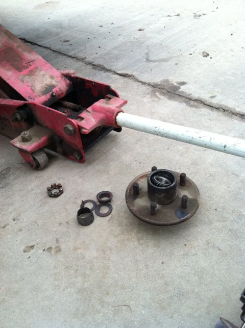

the replacement parts came from a donor trailer that the garage had in the backyard
all fixed up
Total down time: 1 1/2 hours!!!
Total cost: $50

E I am not seeing a cotter pin in the first picture?

Yea, what the heck, I don't see the cotter pin either... :?

No cotter key, bad, bad.
