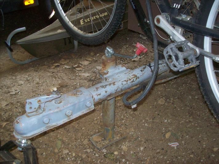

This is what I did. Got it on EBAY. :thinking:

I've bought one similar to Gage's from etrailer, but you have to consider the tube length below the mounting flange as the are various lengths available.

What Gage did! You can get one without the triangular bolt-on bracket, get the bracket separately, then weld it to the tube where you get the best clearance and ease of wheel installation.

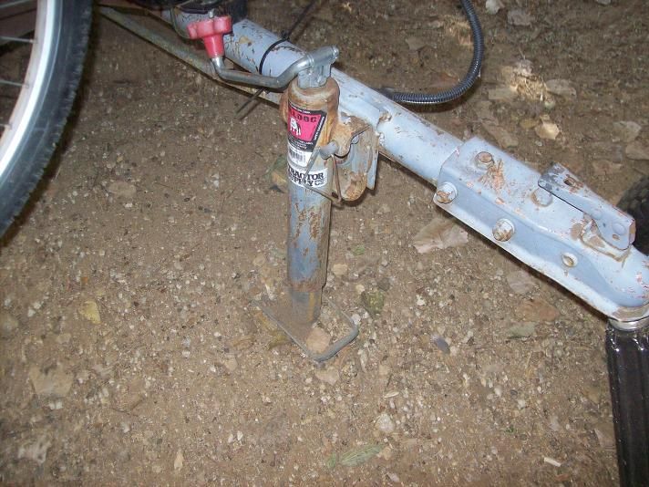

I bought this from Tractor Supply several years ago. It has a flat plate about 4 inches square with a 1/2 - 3/4 inch angle on the top. Was easily welded to this 2-1/2" round tongue but would work just as well with a square or rectangular tongue. I'm planning on using the same for the 1947 KIT I am rebuilding.
To me the drawback with any bolt-on swing away hitch, whether on a round or flat tongue, is the bolted bracket will slip unless installed in holes drilled through the tongue.
The weld took all of about 5 minutes with a bead along the entire top and two smaller ones on each side, a little grinding, and a shot of spray paint.

Latley I've found these at TSC with just the round tube the jack pivots on and not the plate already attached to it. Would work the same way, look a lot neater (the bottom of my plate hangs below the round tongue) and provide a stronger weld if the tube was cut back some to match the profile of the tongue.
Another alternative would be to first weld the tube to a smaller plate or short piece of c channel just slightly smaller than a round tongue or slightly larger than a square tongue. That would provide 4 good weld points.
