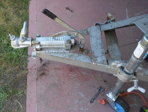

Postby Irmo Atomics » Tue Feb 12, 2013 5:38 am
Here's a picture of an over run brake set-up.
cable brake (500x380).jpg (158.73 KiB) Viewed 374 times
Here are some details: http://caravanchronicles.com/guides/und ... e-systems/
That looks like a modified tubeloc scaffold clamp that they used to attach the (removable) jockey wheel.
