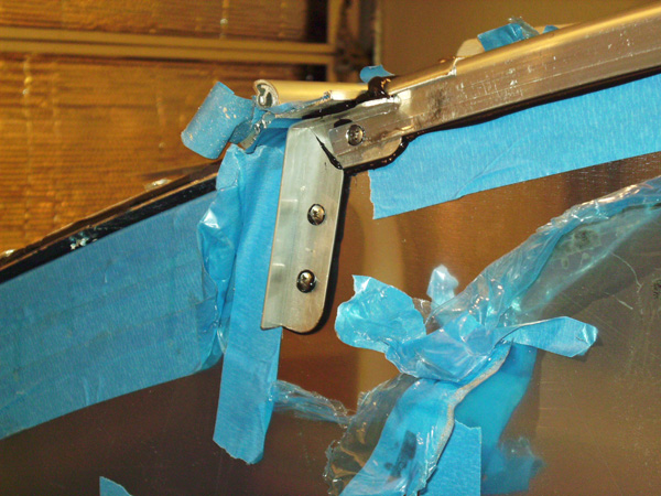

I floated the aluminum skin, but I did use a sealant around the perimeter and around openings in addition to edge trim holding it in place.

I did not use butyl tape other than to weather-seal the windows in my doors. Butyl tape is good and has a proven track record, but it does shrink and become brittle over time. Admittedly, I was probably over-paranoid about water infiltration, so for everything else, I used 3M 4200 adhesive sealant. This is a very good product but is expensive. I didn't find out about it until later, but OSI has a gutter sealant that is probably just as good and is available at most lumber yards. BTW - I would not recomend silicone sealants.
I used the sealant around the perimeter and openings of the aluminum, on the roof vent, underneath aluminum trim (no butyl tape), and in fastener holes.
