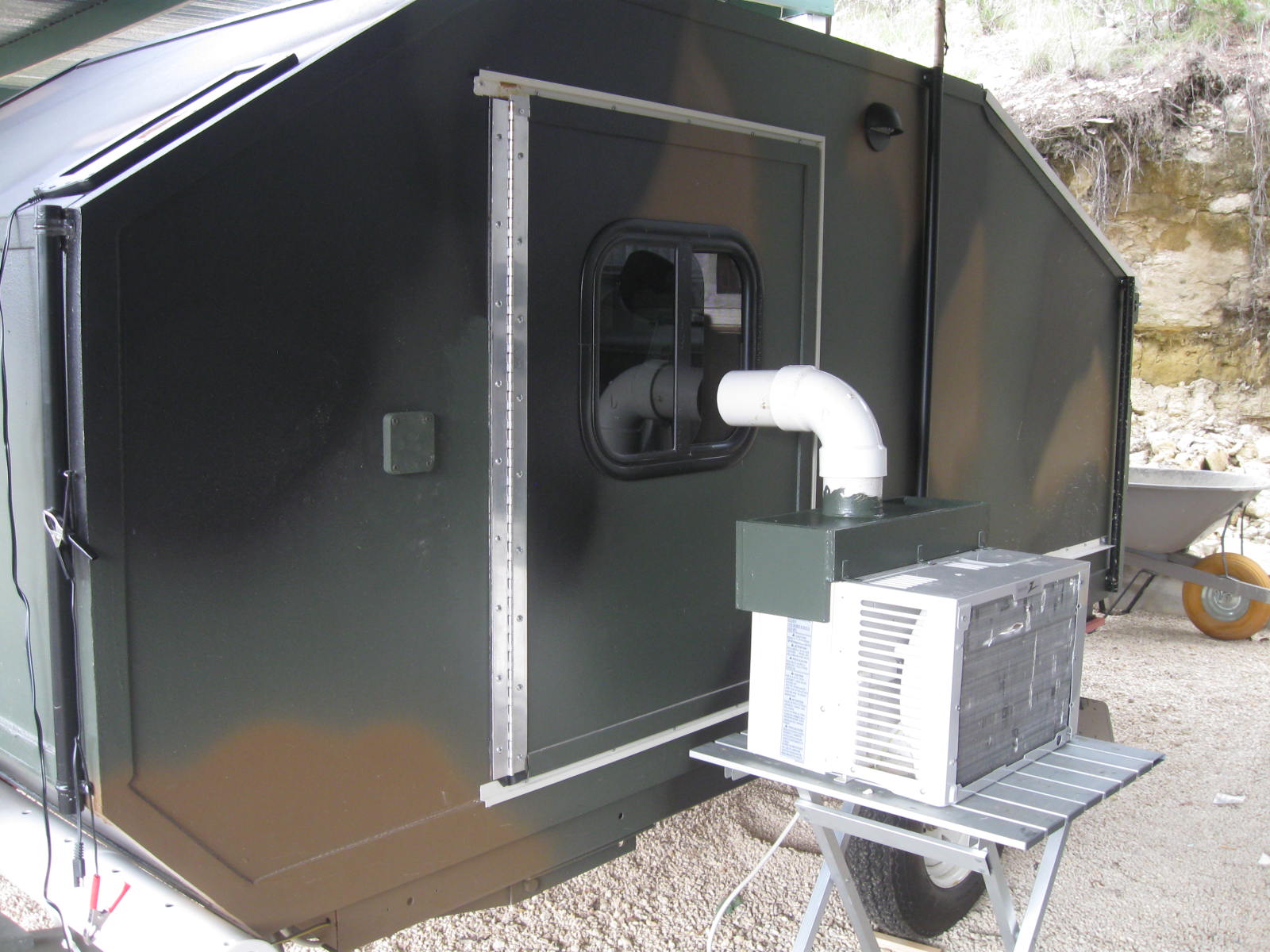

OK, I did a mock up using left over insulation foam and duct tape. Worked very well. So I spent a few hours making something permanent and easy to set up with minimal intrusion to the trailer structure. Plug with circut breaker switch is neatly mounted inside for on-off switch. I can also regulate by moving the window glass. I can tell you, putting the pipe up close too the window is too close. I'll have to keep it a few inches away. I will experiment with a dog house type set up over the vent fan for use in the rain. I'm interested in the "Pet cool". Sounds like a smaller AC unit or something. This unit is definately overkill

kd5edj63 wrote:I can also regulate by moving the window glass. I can tell you, putting the pipe up close too the window is too close. I'll have to keep it a few inches away. I will experiment with a dog house type set up over the vent fan for use in the rain.
If I'm reading this right, you're intending to "aim" the end of the pipe into the opened slider, but still allowing unfilled, un-screened, space all around the pipe? In my experience, it seems that you're asking for unwanted insect incursions (and pollen, and dust free entry also). Part of the beauty of air conditioning is that it filters out those items. By leaving even the smallest crack in the armor (the opened window), the bad stuff gains entry. When I use my A/C, I still use slightly opened, screened vents, but I have computer fans blowing outward thru them, hopefully keeping pollen and dust out as well. Other than that, with a rainshield over your unit, it looks like it'll work. Still, Tom's suggested thermostat would be a good addition, for temp control while sleeping (especially).

Everything should be fine. The windows have screens. This set up is a 5 star hotel compared to an M1A1 tank in Iraq :thumbsup: I can handle a little dust and pollin
