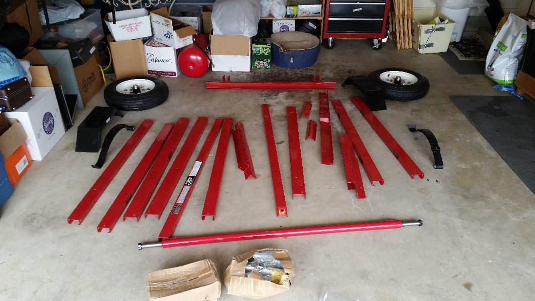

The plans have not arrived yet (Big Woody), but I bought the trailer last week and begin putting it together.
The shrink wrap with parts sticking out shoulda been a red flag:
Giving new meaning to the term "some assembly required"
Anyone see something missing from this picture? I hope HF will send me a new coupler base that was missing from the package.

You mean they didn't give you those red plates that the coupler attaches to?
Bummer!

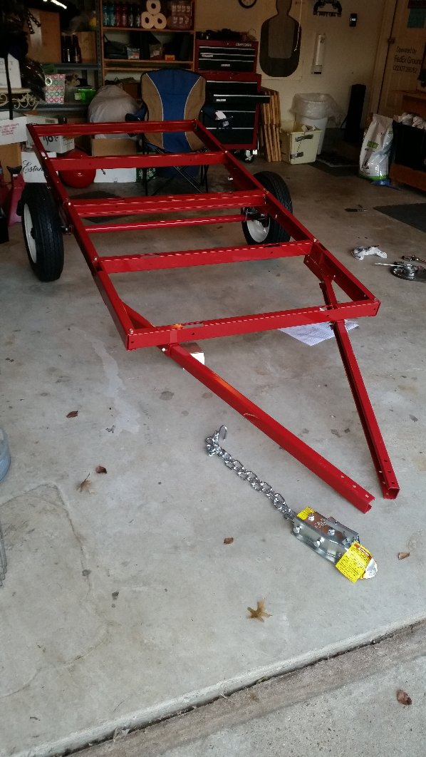

Nope, no red plate. And after reading someone else's post I realized the frame is nowhere near square. I don't have plywood yet, but I'm pretty sure it's not gonna fit without it looking bad, not to mention, difficult to attach.

Go get two ratchet straps make a X corner to corner .Just snug the nuts then pull square

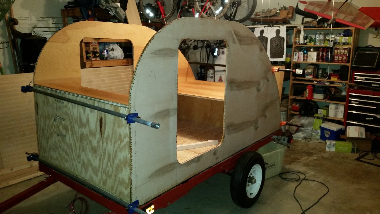

Here is mine finished...
Good luck!

I bought some ratchet straps like 123jay suggested, I was gonna need them anyway. That will definitely hold it square till I get the floor mounted.
My biggest obstacle now is acquiring the missing "coupler base." HF said they could order one for me but it wold take 10 weeks :( I'm hoping my local store will "rob" one from another trailer kit, that is, if one comes in on their truck. It will probably be spring before I finish the build, but I was hoping to use the trailer to haul our tent camping gear in the meantime.
