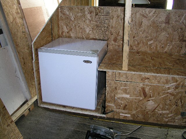

P.S. I'm surprised no one asked any more about the refrigerator... Here's a picture to give you an idea how it might look... :D
P.P.S. Was that twopence or twopenny?

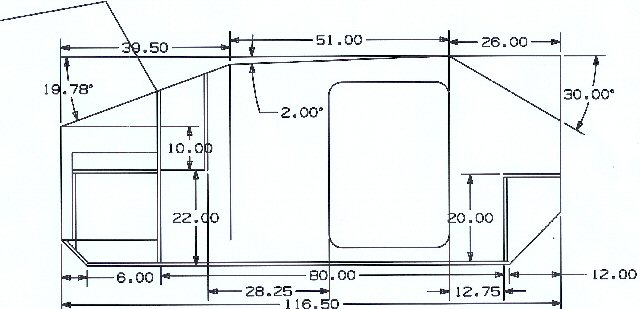

Postby mikeschn » Sat Aug 07, 2004 8:39 am
Oh the plan changed slightly too! A higher backend so we can get the coffee pot in there, a hatch that goes all the way to the floor so we can open the door to the fridge, and it's a few inches longer too.
Now's the time to tell me, what did I miss/forget?

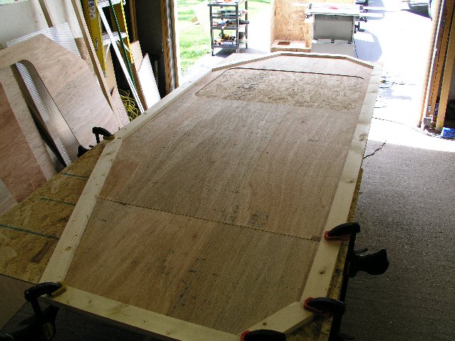

Insulated sidewalls stink. They are hard to build, the two sides don't match, and they take all day to build. :cry:
I have two of these now, and that's all I have to show for a day outside. Lets see, these sidewalls, with the inner skin will weigh about 50#.
That's 25# for the outside luan, 12# for the inside birch, and 13# of pine framing.
I could have gotten a piece of 1/2" plywood for the same weight!!!!!
So that sounds like another lesson learned!
P.S. I gotta stop learning lessons like this!!!
P.P.S. My 13 yr old told me she wants a "Weekender" when she is 16 so she can go camping!!!

Postby Grant » Sat Aug 07, 2004 8:29 pm
"Insulated sidewalls stink. They are hard to build, the two sides don't match, and they take all day to build."
Ummmm, Mike ...
... sounds like a good argument for cutting the walls out (together) first, then building the framework to match, eh what? ;-} ;-}
"That's 25# for the outside luan, 12# for the inside birch, and 13# of pine framing. "
So, you ended up with a 1-1/8" INSULATED wall that weghs the same as a 1/2" UN-insulated wall? Sounds O.K. to me. I think I'd have gone with 1x2s for the perimeter frames instead of the 1x4s, but that'd only save 6-1/2#.
Oh and, hey - don't get too discouraged! Your kids are watching, and you DO want them to grow up to be Teardroppers, right?
Just havin' a little fun with ya, Mike! Enjoy the build - EVERY teardrop is a learning experience, even the ones I'm building 20 years after I started.

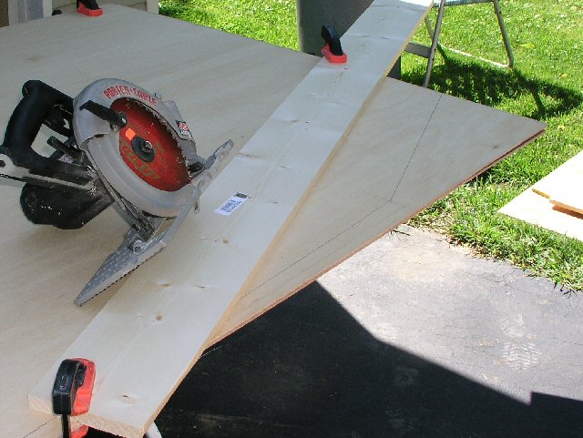

Postby mikeschn » Sun Aug 08, 2004 4:07 am
Oh yes, the two sides were clamped together for cutting...
But here's what I learned... You can't screw thru 2 1/2" wide pieces to make the frame. You can, but you have to make sure you drill straight thru the entire 2 1/2" You have to have long screws, and your angles better be cut perfectly. Not exactly what I would recommend to a butcher!
So instead I glued the framing pieces to the plywood. I'll trim both sides to the same size with a flush trim router bit today.
Maybe I'll even start putting some joists on today! But it's going to be a short day, we have places to go and things to do. :roll:

Postby Chip » Sun Aug 08, 2004 6:46 am
Mike it may be a good thing to take a little more time,,if ya finish real quick then you may be the first charter member of the "4" dropper club or would that be number 5,, :lol: one other thing you could try is make a pattern for the sides and framing and cut all out of one piece of ply,,insulate the cavity areas and lam luan to both sides,,every thing would be same same layout may take a while though.

Postby mikeschn » Sun Aug 08, 2004 6:55 am
I really like the idea of starting with plywood, and cutting out holes for the insulation... but plywood is not quite 3/4" thick, and the polystyrene is a full 3/4" thick.
Maybe I could use that white beadboard insulation???

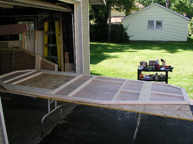

Postby mikeschn » Sun Aug 08, 2004 9:49 am
This morning I stumbled on the easiest way to build and attach the framing to the 1/4" luan. Now some of you guys will say, well hey, that's almost the way I built mine.
Normally when you build a framed wall, you screw the framing to the outside wall, which is typically about 1/2" thick. That doesn't work on 1/4" luan.
Unless... :idea:
... you screw the framing to the table underneath it, and sandwich the 1/4" luan inbetween. :shock:
I've completed the framing for 1 side this morning and it's out there drying.. I would definitely recommend this method to anyone building a 1/4" outside skinned wall!!!
