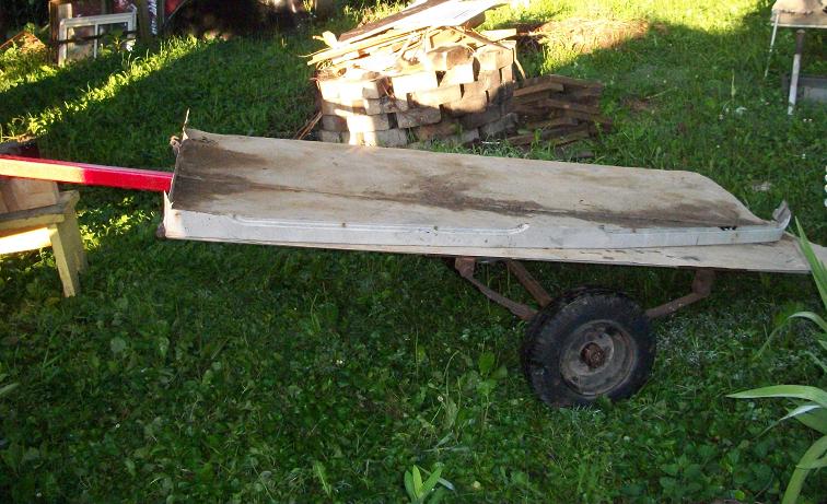

Chubby took four months of week end days as it was my first effort at a full sized teardrop. 160 - 200 ?? hours
Image dtd 5-23-07
Image dtd 5-29-07
Image dtd 9-10-07

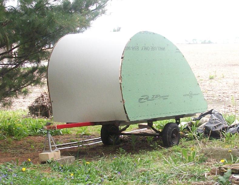

I built the barn in exactly 30 days most of this work was done on very long Saturdays and Sundays. So lets say 90 100 hours.
Image dtd 6-3-09
Image dtd 6-9-09
Image dtd 7-5-09
Image dtd 7-11-09
I had Rip Van Winkle rolling and weather proof in 3 weekends about 60 hours. It took a year on paper but during that time I was derailed building the caboose tiny house and the chuck wagon for the Cross roads of America gathering.
