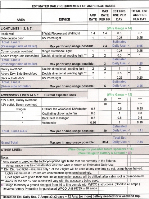

Here ya go:
Again, please remember that this was BL (Before LEDs), so, don't be shocked at the AMPs used.
If this makes sense to you, I can send it to you. (I think I still have your email address.)
It's and Excel spreadsheet and you know how to work with those; so, all you'd have to do is change the amps for your light fixtures, etc; or, send me your info and I can work it up for you.
I forget...I think, #34
