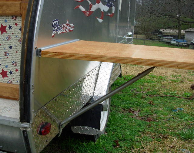

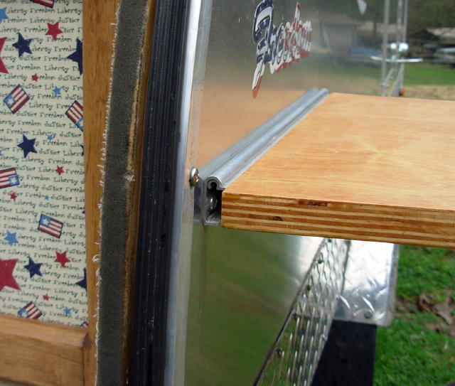

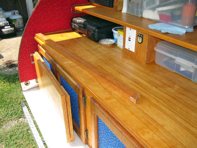

When building our TD in 2006 I figured out pretty quickly that we'd probably need additional 'counter' space so I ordered a couple of 30" pieces of aluminum sliding table support (available online at various suppliers). I 'saved' a piece of 11-ply cabinet grade 3/4" birch plywood (approx 17"x22", from the TD build & cut the sliding table support in half (so I'd have enough for 2 small tables), & after cutting & varnishing the table top I fastened the 'male' table support to the end of the table, & the 2 mating 'female' pieces to the outside of each side of our TD galley. I devised a leg support from aluminum EMT, hinged one end to the underside of the table, flattened the other end, drilled a 3/8" hole in it at the appropriate spot, placed the table on the outside bracket, leveled the table, & drilled a 3/8" hole in the trim/overhang at bottom of my TD. I use a 3/8" bolt through the 'leg' of the table to hold it level & in place for use. I've placed a 7-gallon water jug (full) on the table while camping but it usually carries a lighter load. Have never built a second 'table for the other side since on our first 'gathering' in 2006 I found a folding, permanently mounted table that folds & stores just inside the galley hatch. I built & installed that & so far we haven't found an overpowering need for a second table...
Driver side female table bracket & leg support hole
Folding table in storage mode; we seldom use the side table but it's kept behind the lower galley doors in case of need.
Harvey, I mounted my rails in reverse of what you did and I have some buckling of the bracket. Is there a right or wrong way to mount them?
Big Woodie, see my build link below and I have used very similar brackets as Harvey, MtnDon and others have used.

I ordered the same stuff that Irrowe did. I've used the same item in a number of campers & always mounted it with the wider 'female' piece as the 'receiver', & used the 'male' piece on the edge of tables/shelves, probably because the 'male' piece is generally the same thickness as the table/shelving material I'm using?? I've placed some fairly heavy loads on the tables & they've always held up well. No buckling or collapse...
