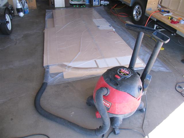

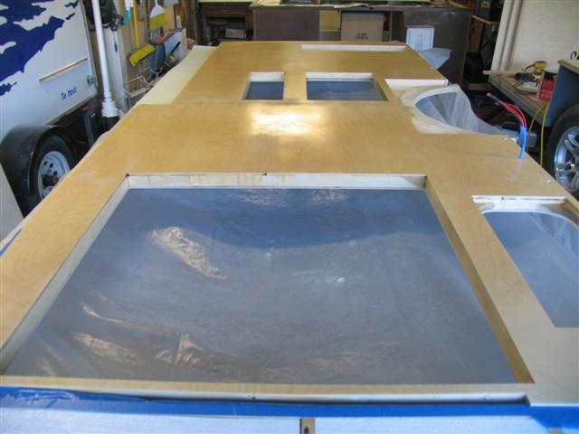

I didn't use any screws for mine and it's been fine over the last 9 years:
Of course I applied several tons of clamping force while the glue set by vacuum clamping the sides:
