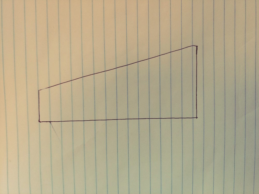

My thread is a bit tongue-in-cheek but I started thinking about all the difficulties that everyone seems to have when building the teardrop and a lot of it seems to be around the curved roof. Is it sexy? Definitely. Is it more attractive than a non curved roof? You bet your sweet bippy. Does it add and cause a lot of frustration? I think so. I guess it might save a few miles per gallon because it's more aerodynamic but I'm honestly considering not having a curved roof. Please see my highly artistic and scientific drawing.
Depending on the slope of the curve it seems like you do get more space inside as opposed to my design and I would have to reconfigure how to open up to the galley but it's a thought....

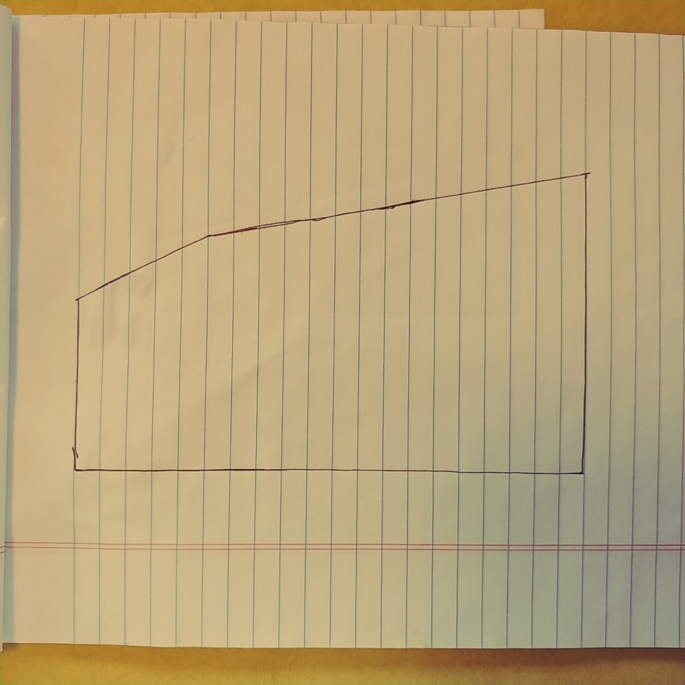

After a lot of thought (5 minutes) I've altered the design to give it more room inside but still no curved roof.

Postby troubleScottie » Sun Aug 05, 2018 9:02 pm
The rational of the curve is to reduce the air resistance. Look up the resistance/air flow over various shapes. The half wing is very efficient.
The square back is a big drag -- bigger than the wing and many other designs.
You can make it more inefficient -- having a larger cross section than the towing vehicle either higher or wider or lower. To a fair extent, the trailer and the towing vehicle act more like two objects due to the spacing between the two and turbulence between the vehicles.
The other issue is making the teardrop light in weight. Lower walls, smaller walls eg wing vs rectangle, narrow eg 4 feet or 5 feet. Generally less materials equates to less weight.
Why does the design need to be more efficient? The teardrop is being towed by a smaller, low tow weight vehicle. If you are building for a 3/4 ton pickup with a tow package, you may not care. Building for a Prius, you have to be.

Thanks Michael for your thoughts....all of them make perfect sense.
I'm still debating on what to do but I have stumbled across Mike's Weekender and that is very appealing to a first-time Builder like me.
