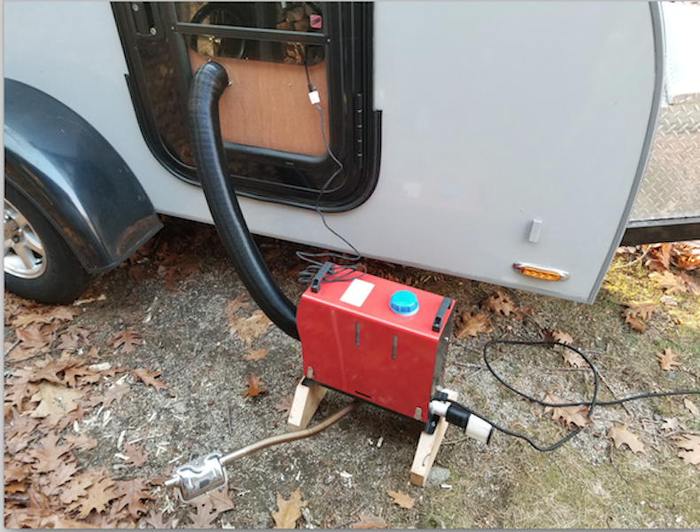

Screen Shot 2020-12-05 at 8.37.38 AM.png (878.14 KiB) Viewed 2424 times
I've had good experience with my all in one diesel heater.
unlike propane which can produce 4 cubic feet of water vapor for every cubic foot burned this is dry heat.
economical, as little as 0.1 litres diesel per hour at maybe 1 amp battery load steady over nite heat.
yes, glow plug can draw up to 10 amps but that's initial start, maybe once a day.
mine is wired to use trailer plug so I can run the vehicle for 10 min for the extra juice.
cabin temp is thermostat controlled
exhaust is clean, no diesel smells with this setup

Postby saltydawg » Sat Dec 05, 2020 8:21 am
Yeah I thought about going to an all in one as I think its the only way I could use one. Some people put an adjustable diverter in the line so they can adjust it to not send all the heat inside. That makes sense, but now its something else to carry around, I would prefer an installed system.

Postby rbtrary » Sat Dec 05, 2020 8:51 am
no need for heat duct diverters
mine came with this programmable lcd controller
when programmed correctly its simple and reliable off the grid heat
https://www.amazon.com/Heater-Monitor-C ... 158&sr=8-3
I read that FB group mentioned and its primarily for troubleshooting so most posts about poor installations/setup issues/user errs
for a comprehensive understanding of these Eberspacher clones
seek out youtube videos by
John McK 47
