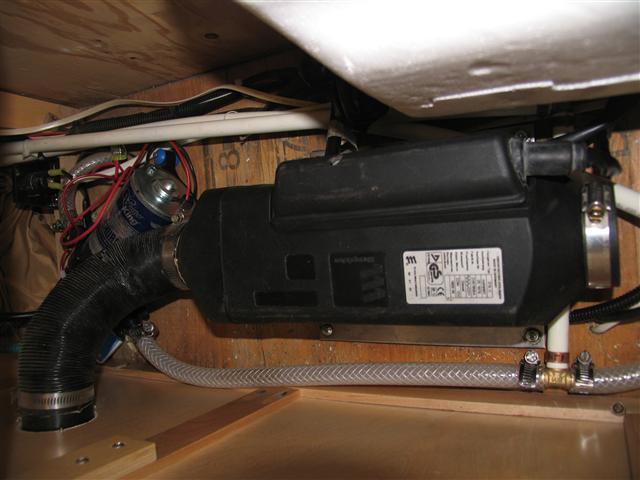

Postby bdosborn » Wed Dec 23, 2020 7:24 pm
saltydawg wrote:Diesel heaters work, but do have issues. They dont cycle they just turn down lower, they can in some situation over heat the trailer. They are cheap.
Chinese knockoff diesel heaters are cheap and may not cycle. The real ones - Espar, Eberspacher or Webasto turn down very nicely but they're not cheap. As usual, you get what you pay for. I love my little Espar D1C diesel heater.
You can read about mine in a maintenance post I did: http://www.tnttt.com/viewtopic.php?t=41232&p=760978
