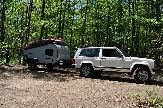

I carry our kayaks on the trailer. I built a rack with a view to keeping them as tight as possible to the roof and lid of the trailer. I've towed with and without the kayaks and there's no significant difference in the gas mileage. I could be wrong but I think the mileage would be worse if they were on top of my vehicle.
One down side to doing it this way is that when you are camping you are limited to kayaking close to your site. I'm currently building "short distance" racks for my tow vehicles (I tow a Jeep Wrangler too) which will allow us to load the kayaks on the vehicle(s) and take off for the day to kayak at another spot. Packing up the trailer for a day trip is NOT something we want to do.
