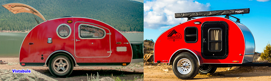

Good Morning....We would like to somehow incorporate a toilet (https://natureshead.net/) into our trailer. I was thinking if the galley were half the trailer's width, I could bump out the trailer's cabin into the galley's other half and create a small toilet space. However, the way the teardrop profile tapers down toward the galley, that taper limits the room for "sitting" in the toilet space. I then thought about reversing the profile, having the profile's taller end at the rear (I'd like to stay away from the boxy shape of a Benroy). I've been looking at the Vistabule trailer and that seems to have a pleasing profile with a reverse teardrop shape (see attached). So, my question is, does anyone have any thoughts about how a reverse teardrop travels. Does it put more stress on the tow vehicle, aerodynamics and all? Any other thoughts "about this plan" would be appreciated.

I was more interested in getting other's thoughts on how a reverse teardrop shape might drive on the road being pulled by my Subaru.
Would there be a big difference in the aerodynamics? (guess I put a little too much emphasis on the toilet in my original post :-)

...other's thoughts on how a reverse teardrop shape might drive on the road...
I don't have the answer. But keep in mind that an airfoil creates lift on the upper surface and the Vistabule looks like an airfoil. I can't believe it creates much if any downward pressure. Speculation on my part.
There may be a Vistabule forum group you could query about tongue weight/pressure while towing.
Also of note –-and I don't know if this will help-- but Camp-In says their Raindrop gets better mileage than their teardrop-shaped camper.

Postby troubleScottie » Mon Feb 15, 2021 12:17 pm
There are many articles here on drag or the effect of shape. Search for "drag".
Many factors to consider. A lot depends on the tow vehicle and the relative shape and size of the trailer. The same design when towed by a truck versus a Prius will have big consequences. In following the site for years, there has been no comprehensive attempt to measure or quantify performance of any teardrop design/shape/manufacturer with various tow vehicles. People appear to either live with a design's deficiencies or build a new one.
A reverse TD design changes your half wing into a wedge. Most likely increasing the drag. Is that significant? I do not know.
In general, the optimum design is a half wing whose front cross sectional area is in the shadow of the tow vehicle. All other variations will have more drag. Increased drag will affect gas mileage, etc. The other factor is the mass of the trailer. Again, less is better. Then, the next question becomes what can you live with (or without).
