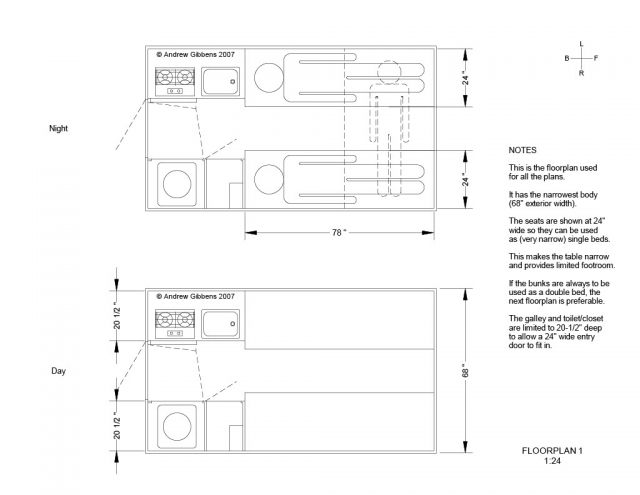

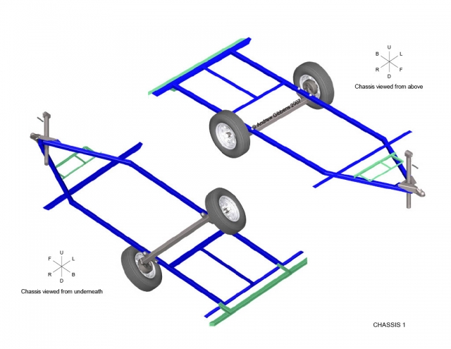

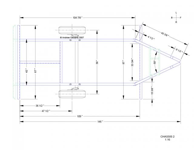

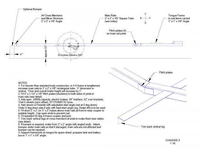

I'm contemplating building the Compact III by Andy Gibbons and have a general question about the chassis. I've included images of his chassis plan. To me this chassis design looks to be a very light construction. Would you add more frame under this trailer? Or any other changes you can suggest? Thanks.
My intention is to build with foam so the trailer will likely have a dry weight of less than 1K lbs. The trailer will be welded up by someone else as welding skills are not my thing. The floor plan is approximately 68" x 114". The aisle is intended to be less than 36" of the rear and the balance is bed/table/bench area. Suggested materials specs are on the third photo.
Most likely layout is below.
Assuming you use a torsion axle, it'll act as a cross-member. But I think another cross-member is needed between the axle and the front angle piece. Just another piece of 1/8" angle. If nothing else, it's needed to support the floor.

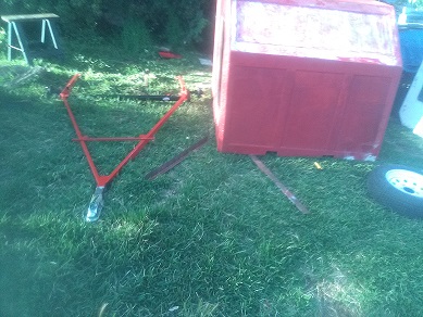

we been using Andrew Gibbons frame plans on our rentals had one rear-ended on the freeway had another one flipped and rolled down the side hill like a ball and they still seem to hold up great.
The Pod has a lot of support.

The frame seems fine. Whether or not more steel is needed to support the floor depends on floor design.
I like the floor plan - center front or rear entrance makes lots of things work better. I do wonder if a plan 7' wide allowing sleeping crosswise doesn't use space better. Does suggest a couple rather than just friends. :)

Postby saywhatthat » Sat Jul 10, 2021 7:56 pm
did not the original have a spacer between the bunks to make it in to a one bed . How much weight and build time do you think you would save buy going back to the original cloth around the lifting roof ?

Postby TimC » Sat Jul 10, 2021 9:57 pm
saywhatthat wrote:did not the original have a spacer between the bunks to make it into one bed . How much weight and build time do you think you would save buy going back to the original cloth around the lifting roof ?
I think the plan mentions a solid bed across as an option using the table top. I like the idea of a space between them. I have been in bedrooms where I have to crawl from the foot of the bed to get in and out and I really dislike that.
I haven't given much thought to hard or soft sides for the pop top. I think that with the versatility of foam there is the possibility of foam sides, at least two of the three. Fabric seems to have potential folding issues. Like when they fold the wrong direction and cause storing problems.
Tim

saywhatthat wrote:we been using Andrew Gibbons frame plans on our rentals had one rear-ended on the freeway had another one flipped and rolled down the side hill like a ball and they still seem to hold up great.
Are you saying don't worry about adding more structure? It is reassuring that the frames are tougher than they appear. The cabin does add some structural strength. I keep forgetting that.

tony.latham wrote:Assuming you use a torsion axle, it'll act as a cross-member. But I think another cross-member is needed between the axle and the front angle piece. Just another piece of 1/8" angle. If nothing else, it's needed to support the floor.
I'm with Tony, you need more cross members especially if you're going to walk on the floor. I added a frame member down the aisle after I walked on the floor before fastening it down. I followed the span rating of the ply but the floor was *super* spongy before I added the steel. I was afraid my fat ass would go through the floor eventually, especially when two of us were standing on it.

Postby tony.latham » Sun Jul 11, 2021 12:22 pm
I'm guessing on torsion axles they have a solid cross member spanning the frame?
Yes, they do and they add much more lateral stability than a standard spring axle.
