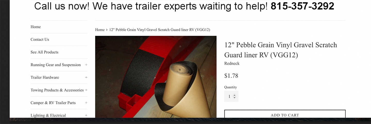

Hello... I'm asking if members have any thoughts / experience they can share using a black peel and stick gravel guard? I've noticed a number of "produced" trailers use a black material on the lower portion of the cabin which I assume is a protective layer against gravel and other road hazards. I'm thinking what they use is high density polyethylene sheet that is integral with the wood siding. Since I didn't have the foresight to design my sidewalls like that, I'm wondering how well these peel and stick products work, as an alternative. I'm thinking of covering the first 7 or so inches over the aluminum siding with the peel and stick. I also had a thought of, instead, using a 7 inch sheet of black filon over the wood siding (7 inches from the bottom of the cabin) and then overlapping the aluminum siding over the filon 2 inches, or so.
Any thoughts about all this would be welcome and sharing any experience with using either the filon (as mentioned) or the peel and stick product.

Postby Capebuild » Fri Jan 21, 2022 8:07 pm
aggie79 wrote:The amount of damage is probably relative to the type of tow vehicle (clearance height) and road surface (paved versus off-road). If you tow with a car and stay on paved surfaces, you won't have a lot of rock dings.
You're probably correct about this, Tom. I'm just not sure where our travels will take us... could be on some roads that are a bit rocky.
Thanks for the replies.
Anyone use this product (as in photo)? Any experiences with it you can share (using it as a rock guard on trailer's sides while traveling rough terrain.
gravel guard.jpg (252.5 KiB) Viewed 970 times

John, I use that peel and stick rhino liner looking sheeting over the aluminum on the extreme left and right front next to the tongue box.

Thanks again, all, for the follow up. I'm still just thinking about applying the peel and stick product...and whether or not it will make a difference.
I realize it may not only be stones kicking up from my vehicle but it's also from the 16 wheelers that are whizzing by me.
