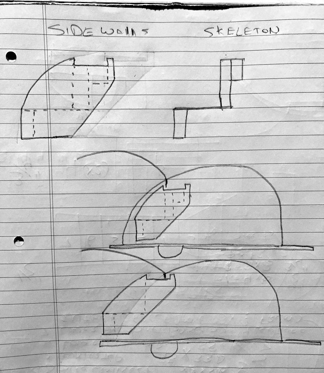

Postby 2bits » Wed Mar 22, 2023 9:10 pm
Hey Tom,
I actually came up with a design yesterday along those lines except not cutting into the existing camper :o you know how much that scares me!! I spent all evening working it out but at this point all I have is a sheet of paper with the design and measurements and I'll save y'all the laughter and not post it but it will basically be a free standing galley set on drawer slides and will slide out flush with that extended ledge. I have some really small RV entry step leveling stands that I can put under each end also. It will slide out 22" total but only extend past the main shell by 12".
Pretty basic design with full walls and a counter top with an upper shelf at the rear and a lower shelf in the front both only being 8" deep, this way when it is retracted at night if for some reason I actually need to use it as a camper I can, but I mainly will still use if for cargo and sleep in the van, I just want every possibility covered in case I sell my big camper and crash the van LOL :oops:
I'll start a build thread once I make sawdust, I made my cut list today and can build the whole thing with two 4x8 sheets of plywood. I would build it this weekend but I am going camping! Going to be great weather!

Postby 2bits » Wed Mar 22, 2023 9:36 pm
Tom, just to touch on your "over extending" thought, I initially thought about simple bolt locks but that would only lock it in place so I'll still do that but as I was designing I realized the back wall sits flush on the spar that hangs down 2" at the hatch hinge and will slide forward and leave a gap behind the galley, so I will extend the walls back just near the top and use the walls to hold in a "plate" just under that bulkhead with a stopper at the end so the bulkhead will ride between the front and rear stoppers.
OK shoot haha I just drew up something halfway presentable to post

Postby aggie79 » Thu Mar 23, 2023 4:56 pm
Cool!
