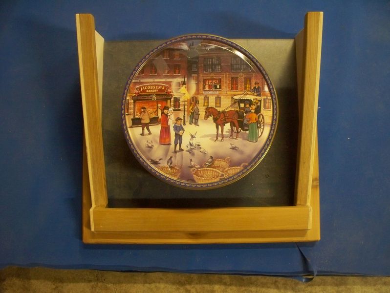

2nd edit: I'm remembering more about Robert's original cookie box heater, thanks to his recent photos posted here. It was in a 5 x 10 camper with only one side door located all the way in the rear in a camper without a galley. The heater was installed inside on the opposite wall without a door.
For anyone with a smaller camper, especially one with two doors the size and placement of a cookie box heater may be a design issue/problem. :(
Many of us, more so those of us with 2 door campers, may have limited unobstructed wall space where we could/can attach a heater. This leads me to think a heater that is narrower than Robert's might fit best. Maybe by using 3 or 4 smaller cookie tins stacked one atop another. :thinking:
Whatcha think? :thinking: :thinking:
Re: Furnace idea.
Postby rowerwet » Wed Nov 20, 2013 9:16 pm
Esteban wrote:2nd edit: I'm remembering more about Robert's original cookie box heater, thanks to his recent photos posted here. It was in a 5 x 10 camper with only one side door located all the way in the rear in a camper without a galley. The heater was installed inside on the opposite wall without a door.
the lack of wall space is what led me to settle on the idea of a box below the floor housing the candle boxes.
it seems looks is another issue for many, four boxes on the wall doesn't fit very well, in a well below the floor with a propperly barricaded vent should look and work fine.
I need to do some measuring around the frame under the floor, I would like to have the vent and well near my feet/wheel well, but keep coming back to the best space being along side the pillow.
the only possible drawback to below floor location being the lack of radiant heat (warm sunshine on your face) from the cookie tins, below the floor all the heat will be convection (hot air rising)
I like below the floor also as I think it will do a better job of getting the heat down to the level I'm sleeping at. back when I was first sleeping in my tear it was a cold spring, I had a small ceramic heater on the shelf above the bed (to keep any blankets or clothes off) I ended up with nice hot air above me, and a cold mattress. :thumbdown:

I think if I was doing this, I would go with one box off set from the wall a little. Then I would put a shield or partially open box around it. The shield would keep from getting burns, and would also provide an air path around your burner box for a computer fan to draw more heat off.
At the very least I would experiment with one box first and see how much heat your can get off of it. Easier to problem solve venting and sealing issues on one first.
