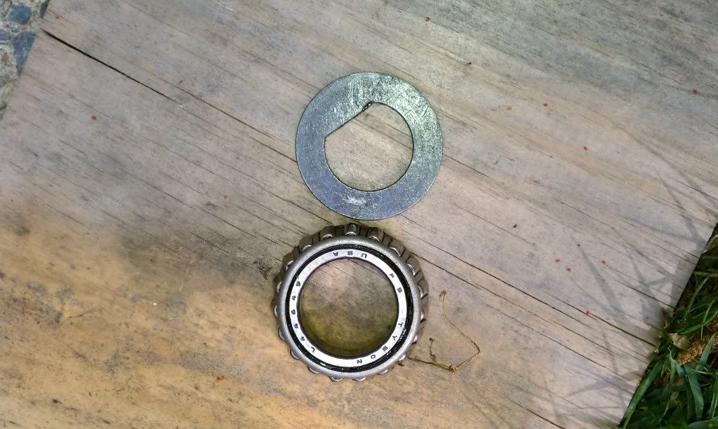

Hmmmm. Yes, bearings are in two parts, but one part should be an interference fit in the hub (called the "cup"). Generally the part that falls out is the one with roller bearings in it, and is called the "cone." Pics would certainly help!

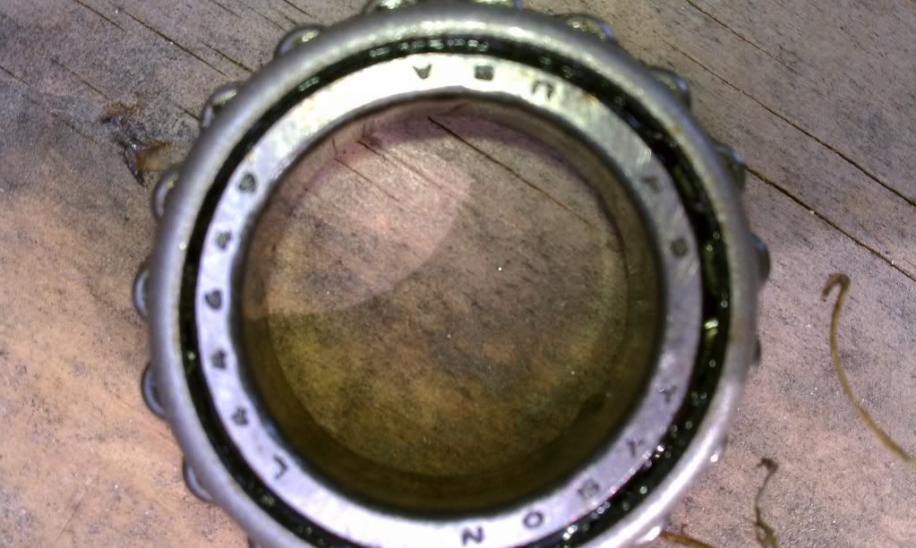

Whoo hoo!! I did it! I did it!! Ok, the number is in case you can't make it out: Tyson L44649

I thought bearings were round like silver marbles? At least that is what fell out of one of my cars when the CV joint broke!! :lol: My 5 year old nephew was with me at the time and after I parked the car having heard a horrendous noise, he got to the back first and said "Auntie, look! You lost your marbles!!" I swear to god this is true!!

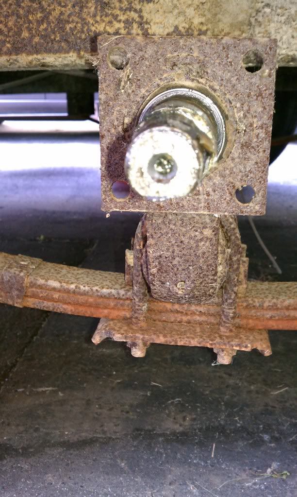

That is a 1 1/16" bearing Pam. I bet the bearing surface is larger where the inner bearing rides? Easy to tell usually just visually. Is the rear of the axle stub the hub rides on the same diameter as where the outer bearing rides?
If you can't tell, take that big screwdriver and pop the seal ou7t of the back of the hub and see if the bearing is the same number or different. If it's different, let me know. I'm figuring it's either the same, or 1 3/8". I can't tell by looking at the pics.
The plate with 4 holes behind the hub is where the backing plate for brakes mount. Are those holes all equidistant, and if so, what is the measurement?

papmom35 wrote:I thought bearings were round like silver marbles? At least that is what fell out of one of my cars when the CV joint broke!! :lol: My 5 year old nephew was with me at the time and after I parked the car having heard a horrendous noise, he got to the back first and said "Auntie, look! You lost your marbles!!" I swear to god this is true!!
Bearings come in all sorts of shapes and sizes Pam, byut axle and hyub bearings genberally look like what came out of yours. L44649 is a very popular bearing size, and is what was on my Sunspot. This is the kit I got to rebuild the hubs: http://www.amazon.com/Trailer-Hub-Beari ... B0000AYCN3
If both your bearings are 1 1/16, that kit is what you would need to rebuild the hubs. There would be another readily available kit if the rear bearing is larger. Also, modern hub/drums would be available to install on that axle no matter what size the rear bearing is. If both are 1 1/6", this hub would work: http://www.etrailer.com/Trailer-Hubs-an ... 16UC3.html
There are plenty of choices.

Postby papmom35 » Wed Jun 08, 2011 9:06 am
Holes are equidistant: 3 3/8" from outside edge to outside edge horizontally and vertically.

Postby frank_a » Wed Jun 08, 2011 9:15 am
It's very unusual to get a seal out without damaging it. That is why they always come with a hub rebuilding kit. Even if I have one that comes out easy (very rare), I replace it with new. Bottom line is there is no other way to get the inner bearing out.
If you look in the hub at the surface these bearings ride, that is the cup. The bearings are really two part, cup and cone. The part that falls out is the cone. The part that stays in is called the cup (or race by some folks). If you can catch your fingernail on any markings on the cups, they need to be replaced.
