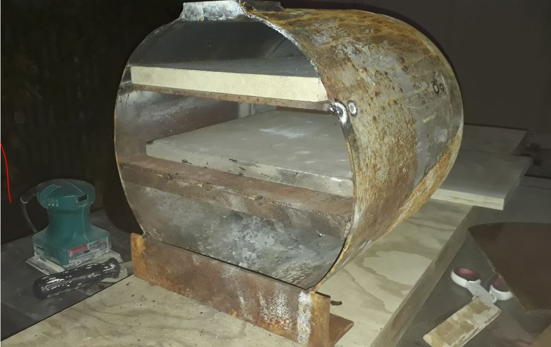

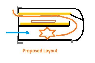

I actually indulged in a bit of welding lately.
I am beyond passionate about real pizza.
Woodfired, done in 90 seconds Neapolitan.
I have for sometime felt the camping experience would be enhanced by a wood fired pizza or three.
So over the last couple of weeks I've been turning half a propane tank into a small, and hopefully portable, wood fired oven.
I estimate 10 hours work so far.
Fire in the bottom section. Hot gases to come up the back of the "oven" and out between the two stones.
Sawn sandstone, hopefully enough thermal mass to do the job.
Trying it out tomorrow.
The theory:
The execution.
Overhead Mass.JPG (96.72 KiB) Viewed 1004 times
Will it work? I'll let you know.
