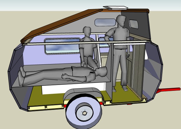

Postby Mstro » Thu Aug 07, 2008 7:44 am
This is a design i've been working on, the height can be adjusted to for taller people, as seen it's 6'4" clearance. the only problem i've been trying to adjust is the door height.
Marc

Postby mikeschn » Thu Aug 07, 2008 9:49 am
Yep the door looks like a problem. Could you using a folding door, like on the Kampmaster?

Postby Mstro » Thu Aug 07, 2008 4:44 pm
Mike thanks for the lead - It pushed the thought process and this is the first thought to show - the fold would be opposite the Kampmaster, Laying down when the top folds, the hard part I see would be support in the door opening during travel, fearing wall flex. Challenging at best :? :?
