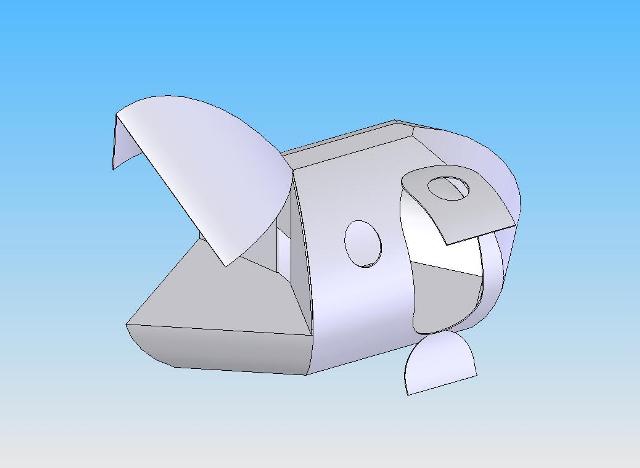

Postby angib » Sun Feb 11, 2007 5:44 pm
In a few days, I'll have a 3D model of the Roswell done and will be able to offer you a VRML file of it..........
I can see the galley idea Grant has described and I'll try to model that, if my brain can stand the stress of working out the 3D details.
Andrew

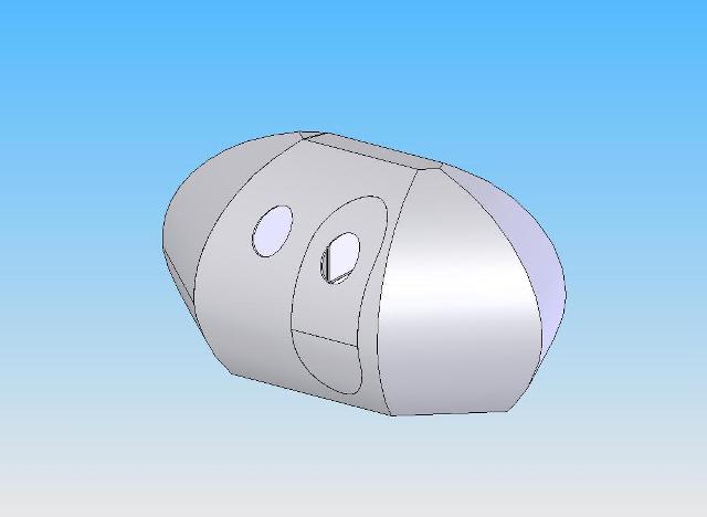

Postby angib » Mon Feb 12, 2007 6:23 pm
OK, so here is the model so far. Grant's hatch will take a bit more work and I'm having real trouble with the VRML.
Andrew

Postby del » Mon Feb 12, 2007 9:16 pm
andrew
the only thing i can say is your work is greatly appreciated, and thank you. that trailer is really groovy, hope you do not mind if i do not paint it green though.
thanks again

Postby grant whipp » Tue Feb 13, 2007 2:22 am
Hey, Andrew!
That's looking really cool! Does your modeling program allow you to, say, raise the fenders about 4", lower the body over the frame about 2" more, and tuck the wheels/tires up into the fenders about 2" more?
Gettin' really close, my friend ... :thumbsup: ... :thumbsup: ...!

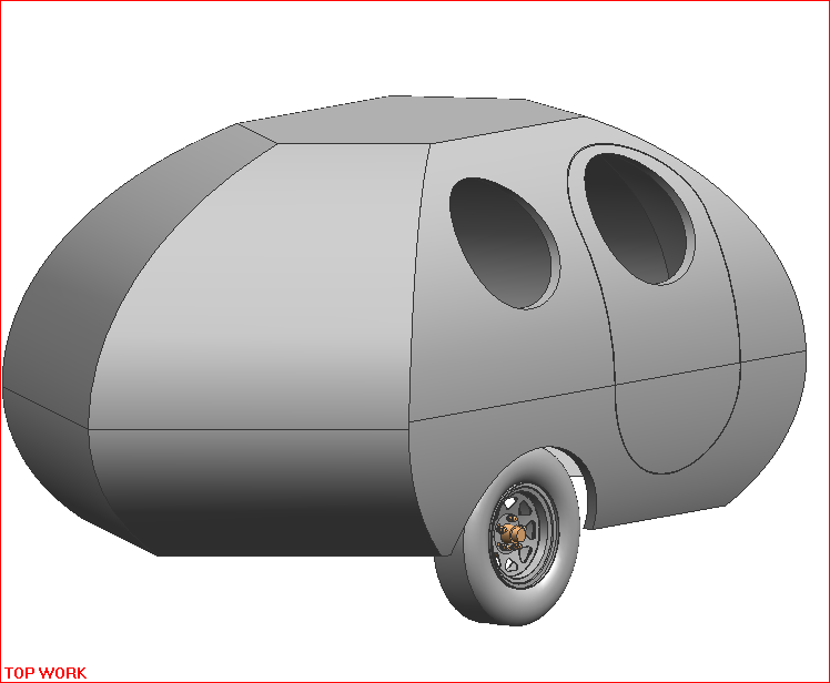

Postby angib » Tue Feb 13, 2007 12:09 pm
Grant Whipp wrote:Does your modeling program allow you to, say, raise the fenders about 4", lower the body over the frame about 2" more, and tuck the wheels/tires up into the fenders about 2" more?
Grant,
Firstly, in my own defence, here is one of the famous sketches of the Roswell with my model overlaid on it in blue. Most of the differences between my model and the sketches are due to inconsistencies between the two views of the sketch!
Here is the model with the changes you described. I've also put a flat on the back of the fenders and added some 59 Caddy tail lights there - though I can see that's not too bright as they'd get knocked off by people walking around the trailer in camp.
The various movements you described mean that the chassis is now recessed a long way into the body - in fact the floor comes slightly above the door opening!
Andrew
