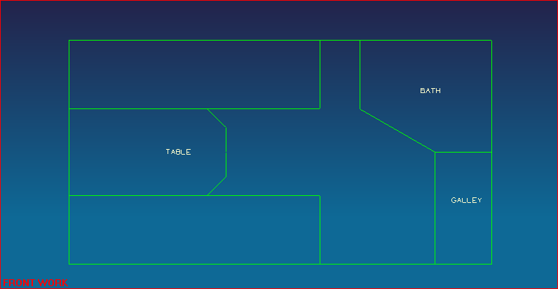

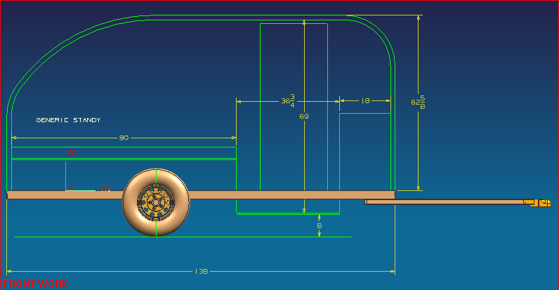

Here's a preliminary sketch... yes, it needs some work... that's why I posted it. Lets have some fun.

Postby fornesto » Thu Jun 14, 2007 12:18 pm
A couple of interesting dimensions for everybody. A standard garage door opening is 7'. A typical porta potti is 15" cubed. I would always like to be able to store or work on the trailer in the garage and at less than 7', you can do that.
As far as inside vs. outside trailer, why not incorporate both? - a rear galley that is partially accessible from the inside via a pass-through.

Postby mikeschn » Thu Jun 14, 2007 12:34 pm
If you put a galley in the back, the shortest ttt you can make is 13' long.
2' galley
7' bed
2' door
2' inside counter
13' total
Unless you sleep across the trailer... and climb over your partner...
2' galley
5' bed
2' door
2' inside counter
11' total
