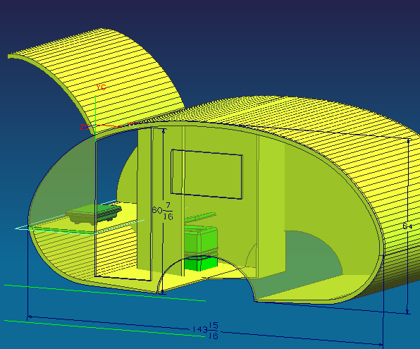

Can someone explain to me why there is not very much interest in design C? I thought the galley being open to the inside AND the outside would make this ideal for a hurricane trailer, or a foul weather trailer. And the coffee pot can go where the stove is... and you can have a bathroom sink in that area too. Furthermore, it's easy to package in a 12' long trailer. Please enlighten me... :?

I didn't vote for it because in the original drawing it looked like the wheel wells encroached in the cabin and the bath. ;) It still looks like they are too far forward but that is probably just what I think and not real. :roll:
The new picture helps. :thumbsup:

mikeschn wrote:Can someone explain to me why there is not very much interest in design C? I thought the galley being open to the inside AND the outside would make this ideal for a hurricane trailer, or a foul weather trailer. And the coffee pot can go where the stove is... and you can have a bathroom sink in that area too. Furthermore, it's easy to package in a 12' long trailer. Please enlighten me... :?
Mike,
I thought the wheel location was a little too far forward, but I envisioned a galley that was heavily loaded. If it was kept simple it makes a lot of sense. The height of the counter-top height accessed from both sides was a consideration as well. On the plus side would be frame design, a drop floor behind the axle would be easy to implement and could be a simple rectangle from just in front of the door to the galley bulkhead going all the way across to include most of the porta/shower room. If torsion half axles were used the drop floor could be extended forward between the axles up to between the bunks. Given more thought, it was probably just the pretty colors of the original drawing of choice "A" that influenced my vote. :lol:
I don't care for fast drop of the front profile; on the whole it reminds me of a bean.
I also think that it will make the interior feel quite closed in.
If you're lounging on the couch it will be hard to put your back forward and your feet aft and get comfortable because of the low ceiling height getting ever lower as it moves forward.
Also compared to "A" (or the other some of the other designs there's much less storage space and it's hard to access and less usuable in shape (like the rounded floor under the galley).
And I agree with others, the wheelwells look like they'd be tough to work around; in the drawing all of the proposed space ahead of the toilet is consumed by wheelwell. And the one on the right looks like it would force the bed/dinette seat quite high.
