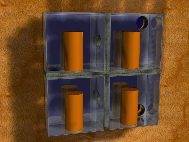

Postby mikeschn » Tue Sep 25, 2007 6:59 pm
So kinda sorta something like this...? (Lids removed for clarity) The candles definitely need to be in a glass container! :)
Postby jeepr » Tue Sep 25, 2007 7:57 pm
Thanks Mike, you are the CAD master! :D

Mike's cad drawing is close to how Spenser's cookie tin heater was built. The candles are much shorter than Mike shows. Long burning Tea Light candles like these from Target would work 7 Hour Tea Light Candles - White (100 Count) Robert used one or more long burning candles in the lowest tin box with an air inlet. Heated air flowed through the other boxes radiating heat into the sleeping cabin and then was exhausted to the outside from the last box on top. The cookie tin covers are held in place with a bolt through the center of the cover and a wing nut. We never got a photo of the heater to share.
