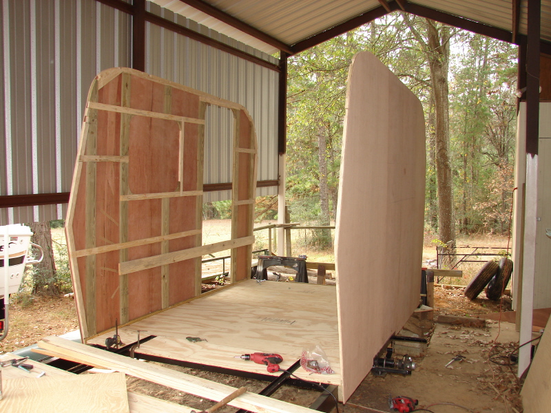

Progress
Postby dploch » Sun Dec 09, 2007 6:43 pm
Me and my Dad worked all weekend and made the following progress
Frame sides
Floor Installed
Sides Skinned
Side Walls Up
Installing wall insulation next and cutting out windows and hatches.

Postby Claw » Sun Dec 09, 2007 7:58 pm
Great to see the progress. It is fun to see a drawing/idea come together. :applause:
