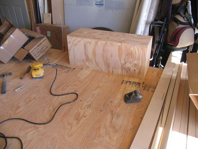

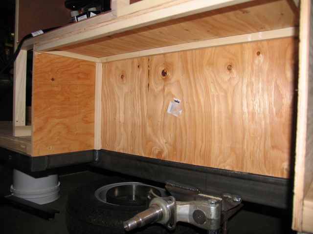

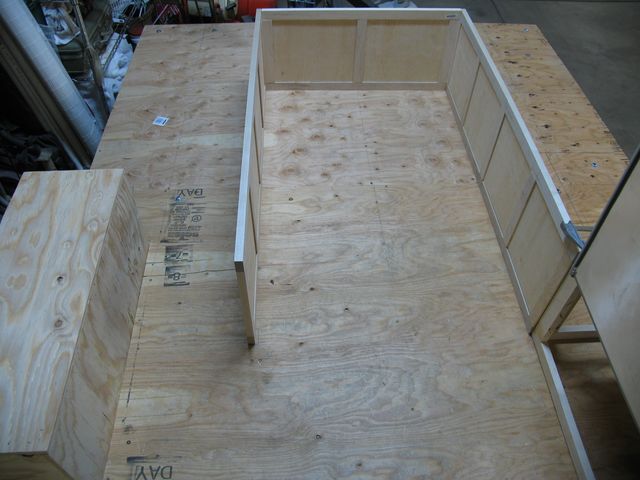

I made some more progress this weekend - I finished the wheel wells. Boy, the decision to use 14" wheels comes back to haunt me with a 12" high wheel well. I wanted tires with enough weight capacity to carry everything safely at highway speeds, I just didn't realize how much interior room it would take. Oh well. I used leftover CDX since its pretty common for a blowout to trash the wheel well. Everything will be replaceable.

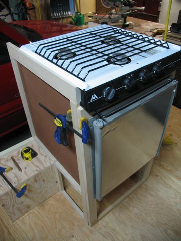

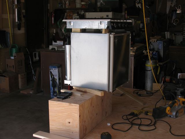

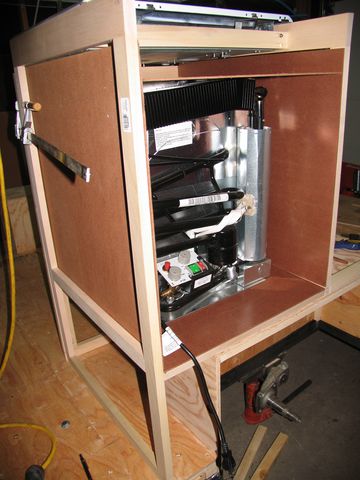

Now I'm starting on the inside cabinets (before I make the walls!). First cabinet will hold the fridge and stove. It took me forever to figure out all the measurements to make it all fit.
There's still a lot of work left with insulating and finishing but it fits pretty good so far. I need to make the fridge compartment airtight so we don't suffocate when its on propane. I also made it too deep so I need to take about 2" off the depth. Its held together with pocket screws, which makes it easy to tweak things until you get it right.

I am curious as to why you framed the steel frame with wood and the then ply on top of that framing. What is the advantage of doing that over putting the ply directly on the steel chassis?

Elumia wrote:I am curious as to why you framed the steel frame with wood and the then ply on top of that framing. What is the advantage of doing that over putting the ply directly on the steel chassis?
Mark
Mark,
This is going to be a standy and 1/2" ply will not span more than about 16" without bending *a lot* with me standing on it. My wife and I will both be standing in about the same spot (at the stove) so it needs extra bracing. I tried spanning 18" without any bracing and it was pretty crackly when I walked on it. I could have braced everything with metal but the wood is tons lighter. I wouldn't have braced it so much if it was a tear; the weight would have been spread out a lot more.

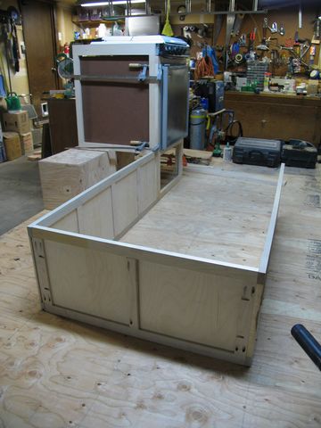

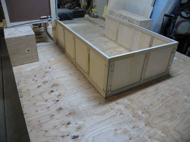

Worked on the bed platform today:
Maple with baltic birch plywood inserts. It hardly weighs anything but its very strong. On to the cabinet for the sink next.

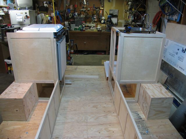

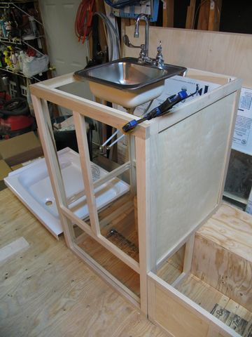

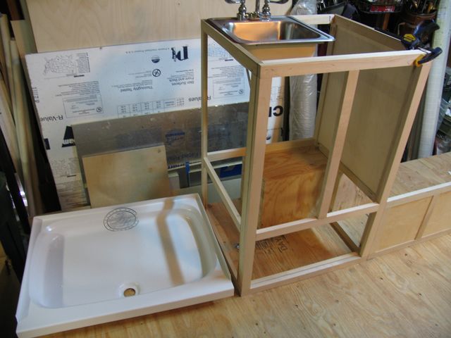

I made the sink cabinet this weekend:

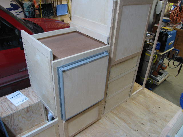

I also added the paneling to the side of the refrigerator cabinet and the front of the fridge. It's getting so you can see how everything will layout. I've got the shower pan sitting where it will go. I'll work on the wardrobe cabinet next. It will go across from the shower.

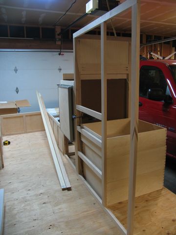

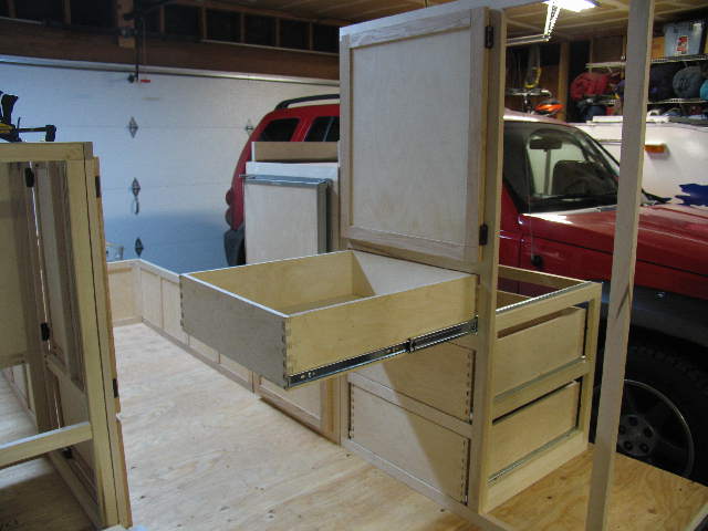

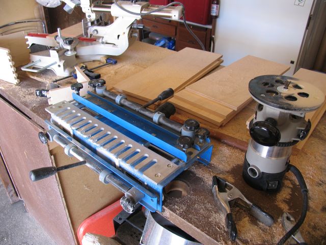

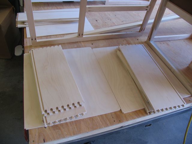

I had a drawer making party this weekend.
1/2" baltic birch plywood for the sides and 1/4" baltic birch for the bottoms. I used the HF dovetail making jig for half blind dovetails. It takes forever to get the jig setup right but it works pretty good once you do. I needed a new dovetail bit but the one I got was too small so I used an old one. It chipped the ends off the pins on the front of the drawers but thats okay because no one will ever see those. I'll start installing the drawers then move on to cabinet doors.

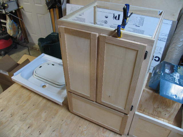

Postby bdosborn » Tue Feb 19, 2008 12:16 am
This weekend I got most of the cabinet doors built and the drawers mounted. Its starting to look pretty cool but I sure do have a lot of sanding to do. :R
The door frames are oak with baltic birch inserts. I've got some of Doug Hodder's aniline dye I need to start experimenting with to see what color looks good but I won't do any finishing for a bit. I've got more to build!!!
