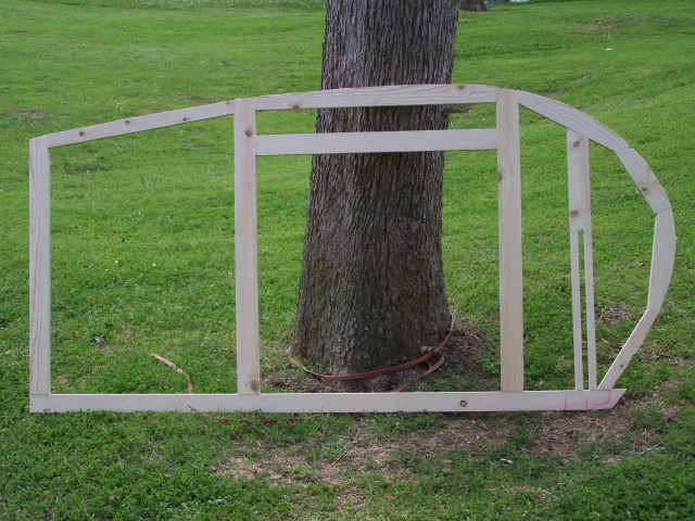

Sonetpro wrote:I like the profile. So how are you going to lay out the inside? Your galley looks to be about the same size as mine.
As you can see I had plenty of room.
You are really getting after it.

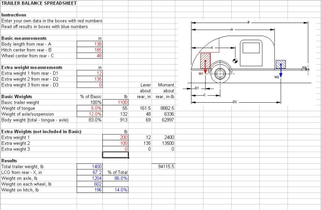

Miriam C. wrote: Have you guesstimated the balance?
Eddielbs wrote:Sonetpro wrote:I like the profile. So how are you going to lay out the inside? Your galley looks to be about the same size as mine.
Thanks Steve,
Well my layout is going to look a lot like yours since I copied your Sketch ':oops:' Hope you don't mind I really liked your layout, it seams to be really workable with the 11'6" profile...
Sonetpro wrote:My axle is right where the cabin wall is. Since my battery's,Petcool and water tank are all in the bulkhead (I carry the generator there too) It puts the weight of them right on the axle. Axle placement was chosen after I built it by having the mounts on a section of angle that slides on the frame. After it was built I slid the axle for optimum placement then drilled holes and bolted them to the frame and mounted the fenders.
