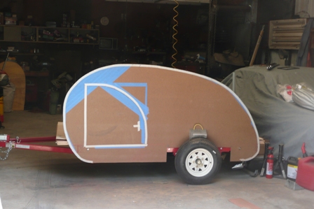

:applause: You have done a great job on the profile. I am wondering if the curve on the door drops off too soon. Does that make sense? I am thinking when you sit in the doorway you might have less head room than you need.
Postby chgrsteve67 » Wed May 14, 2008 12:22 am
I'm waiting to get my fenders before finalizing the door. It may get bigger or smaller.

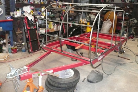

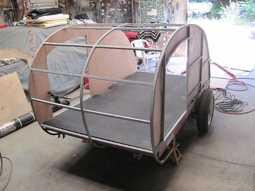

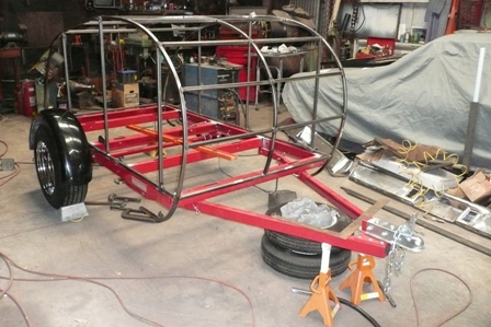

Postby chgrsteve67 » Fri Jun 06, 2008 10:00 pm
Progress has been slow. Have had to wait on people to deliver what they promised. My metal crafter went MIA on me and still hasn't surfaced. Had to make my own template and bend the steel for the frame myself. Still have the doors to do.
Fenders finally arrived and the Steel Smoothies are going to work out perfect. I need to position the fenders and weld in the mounts.
Got my Charger back from the media blaster today.
Time for the body work.
Steve (Its only money - just wish a had a lot more of it)

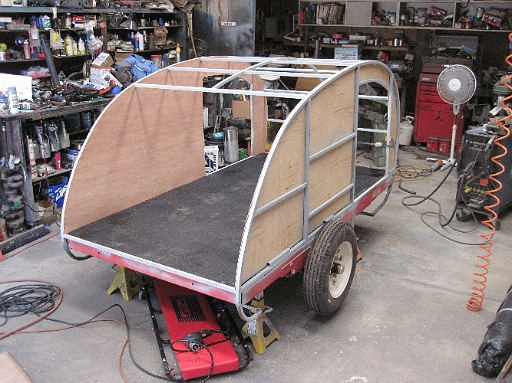

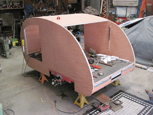

Postby chgrsteve67 » Mon Jun 09, 2008 11:27 am
Got the sides on and the door opening cut.
Still have to put the fenders on to see when I need to add support.

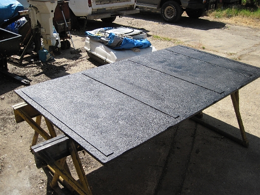

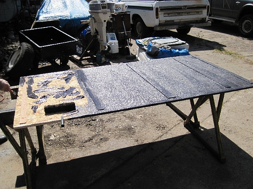

Postby chgrsteve67 » Mon Jun 15, 2009 2:07 pm
Water proofed the floor and installed.
Also installed the inner walls.
Not a lot of progress but prgress none the less.

Postby switterstx » Mon Jun 15, 2009 4:12 pm
Steve,
Excellent progress. I just have my skeleton built but not the sides done and I've been at it almost a year now.
I'm curious how you are fastening the plywood to the metal. And, although I'm already beyond bending the square tubing, I wonder how you did it. I wish I could have pulled off that many curves on mine.
Thanks,
switterstx
Posts: 73
Images: 27
Joined: Mon Jun 11, 2007 1:50 pm
Location: Austin, TX
Postby aggie79 » Mon Jun 15, 2009 4:54 pm
switterstx wrote:Steve, Excellent progress.
I agree. Keep things moving along on the great design and build method. :thumbsup:
switterstx wrote:I'm curious how you are fastening the plywood to the metal.
So am I (and how you plan to attached your exterior skin.)
Thanks, Tom
Postby chgrsteve67 » Mon Jun 15, 2009 8:14 pm
For some of the smaller pieces I made a sqare tubing bender out of a old truck brake pad and a 6 foot piece of pipe. A propane torch to heat up the tubing makes it more plyable.
For the big pieces I used two 1\2 inch sheets of plywood screwed together, cut out to the shape of the trailier, I made a lever that could be positioned in several locations that I used to pull the heated pipe around the template. I made several ancors so after its pulled around the template I could keep the tubing in place and then spray it with water. THis hardens the steel so it keeps its shape and puts out the burning plywood.
I thought about taking pictures of the process but I figured people would laugh.
The walls are secured to the frame with tapered steel screws. When its done you will be able to see about 5 or 6 of them however with a little wood putty I don't think they will be that noticable.
Outer skin will be attached with a combination of liqued nails and finishing screws or rivits.
I just got my exterior clearence lights. But not my Brake lights.
I will be ordering my molding and door hinges tonight.
I still need to make the box to recess my license plate in the rear of the trailer and tail light placement.
I will order my outer skin when I get a lot closer to actually skinning the trailer.
I need to also goto the home improvement store and buy foam insulation for the walls.
I'm just figuring out things as I go along. No plans. :oops:
Don't really know how its all going to trun out when all is said and done.
Steve

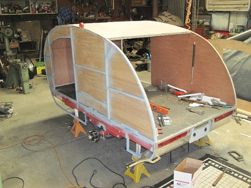

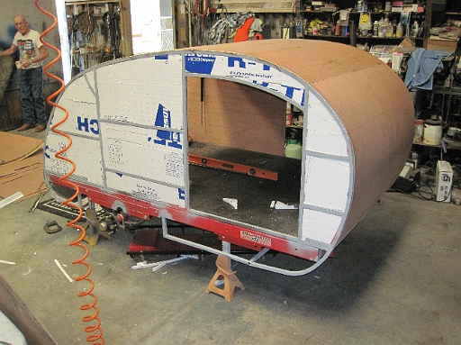

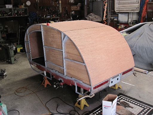

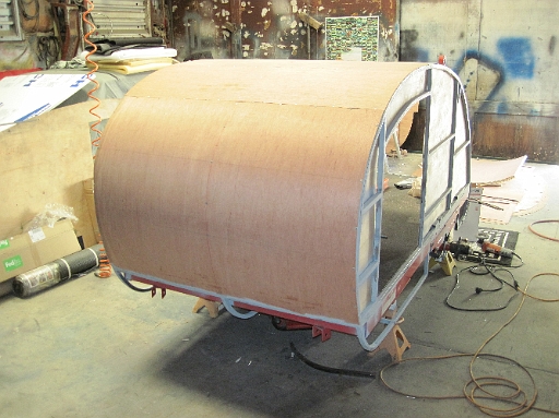

Postby chgrsteve67 » Sat Aug 01, 2009 8:27 pm
Been a little while since I posted any progress pictures.
Progress has been slow, today I got the rest of the insulation installed and the side boards cut.
I need to get my door latches figured out before I can finish skinning and installing them. Next on the list.
Also picked up my aluminum skin today
