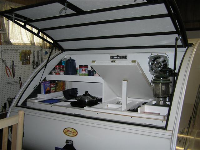

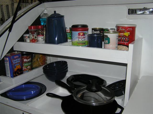

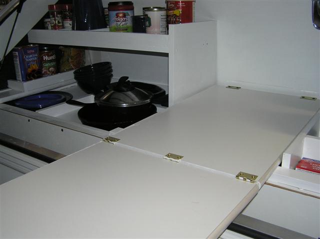

Here's another one we received pics of:
pretty neat, IMO.

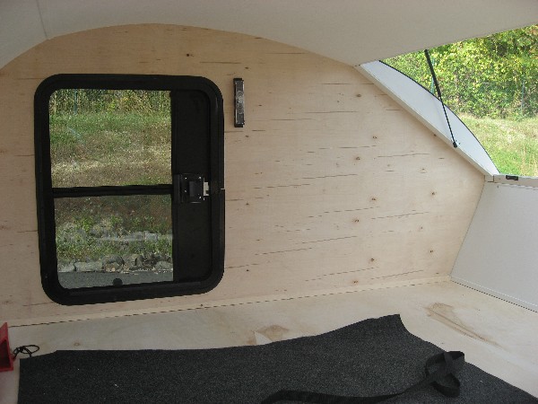

We bought a 2006 Doublewide and did minor improvements to the galley in Summer 07. From the posts here there are apparently different ways the galley is factory finished off? No doubt there all white?
Our concern was/is the sliding effect of frequent starts and stops. I went to West Marine and found the trim to hold the items we knew we would take with us, from sliding off the galley shelf and into the small storage abysis.
The teak railing (foto in my album) was reasonable and it worked. We took the LG XC last summer with no falling items, and zero breakage of any kind.
I am technically challeneged, especially computers & wood working? But lurking here for months, and seeing what others had done, I decided to redo our interior.
Gonzo went all the white ceiling material. Then I insulated the sleeper compartment ceiling. Now what? After considering most ceiling options I tried a cedar planking material and satin poly finish.
The planking scraps (ceiling job) ended up in the galley storage area.
I planked, insulated, and expanded the storage space. And did a similar treatment (plank & insulate)onto the factory foot board. That footboard reinforces the galley shelf in our model. Our hinge and latch are similar to what the orig poster described. It's now almost twice as thick, and three times as solid with minimal weight gain.

I am playing around the idea of bringing the counter top out to the end of the trailer. That would keep gunk from going down on the bed I could put some angle iron there to support it. I still want to be able to lift the counter top( to have access to make the bed). Maybe some better hinges and longer screws would make it stonger on the other side. I think I'll start this weekend!

scott and becky wrote:Yes,I am playing around the idea of bringing the counter top out to the end of the trailer. That would keep gunk from going down on the bed I could put some angle iron there to support it. I still want to be able to lift the counter top( to have access to make the bed). Maybe some better hinges and longer screws would make it stonger on the other side. I think I'll start this weekend!
Scott 8)
What I would recommend is that you lengthen the countertop, and lower it just a touch, to sit at the same level as the hatch opening. Then, cut a "Hatch" in the countertop that hinges, instead of making the whole countertop hinge. That way, you can securely mount the countertop for strength, and have four-sided support for the hatch.

That's what I plan to do. My counter top is in three sections already. All I have to do to start is, pull the center counter and put a longer one in that goes to the back of the trailer. :thinking: I'll still have a hole on each side that I could put some bug baffles over.( Kind of like Terry and Lisa did with thier LG. ):)
