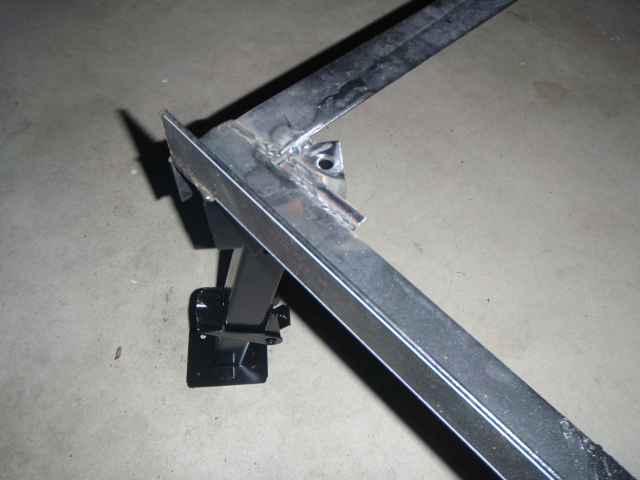

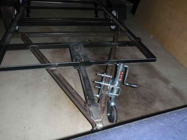

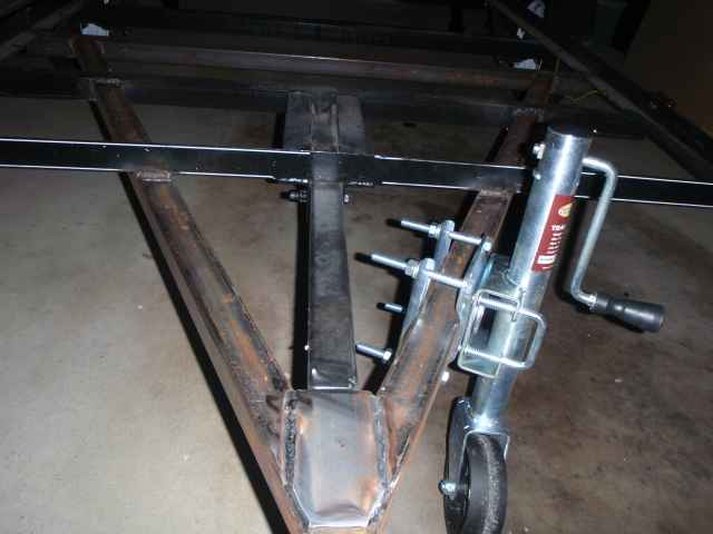

Postby rhltechie » Thu Oct 16, 2008 7:49 pm
Hello all,
my dad returned my trialer tonight. I was impressed with his quick work. H welded some steel for the a frame tongue and another cross member. here are the photos of the after trailer.
He also welded my jacks on the back for me.
I plan on getting the floor done this weekend I hope :thumbsup:

Postby 2bits » Thu Oct 16, 2008 9:59 pm
So what's your plan for doing the floor? Construction-wise I mean, I am just looking at it and it looks like it is angle iron with the outside edge turned up, just wondering how you will do it, alot of choices!
