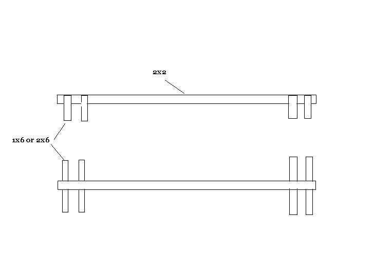

Postby bobhenry » Tue May 15, 2012 11:31 am
I have toyed with almost the same idea on the barn.
It is a bit to tall for my 10 x 10 first up to cover the barn door entrance. I felt if a spreader 2x2 was made the width of the barns rear pluse a few inches a pair of cleats could be added at each end and simply drop it over the opened doors. It will do two things. It will give you a place to drape the awning cover and also hold the doors aligned to the sidewalls of the trailer.

Postby Dant » Tue May 15, 2012 6:07 pm
Great idea Bob! I suppose a guy could just attach the awning to the spreader. There'd be a small gap, but that's fine for a shade awning. Just have to figure a simple way to keep the bar from sliding aft, if I understand your idea.

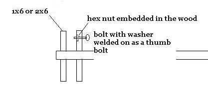

Postby bobhenry » Wed May 16, 2012 7:55 am
Dant wrote:Great idea Bob! I suppose a guy could just attach the awning to the spreader. There'd be a small gap, but that's fine for a shade awning. Just have to figure a simple way to keep the bar from sliding aft, if I understand your idea.
Here is an idea for a set bolt to secure the spreader.
Cheap and ez ( like me ) :D
