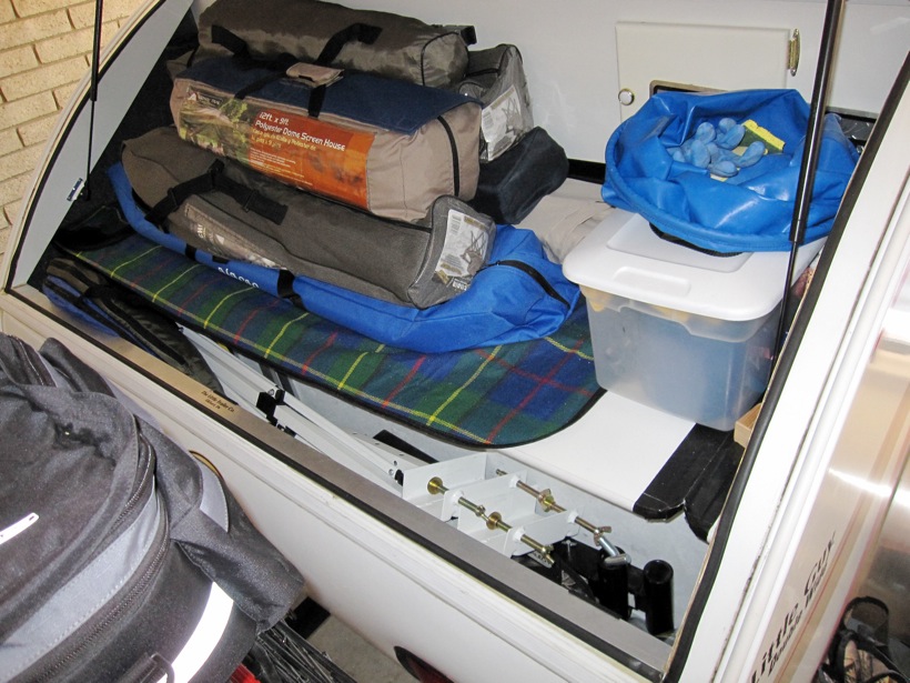

Glad I could help. Yes, everything easily fits in the much talked about rear gap on Little Guy Teardrops. I am fortunate to have a 2006 model year because that was the last year that this gap was enclosed and not open to and looking down on the mattress. (Whew) ...cause I use that area big time for storage. That's why you see guys doing mods on later model years to close it off.

Postby okiecamper » Wed Jul 08, 2009 5:47 am
thanks so much, scott, those last pics of the reciever tubes and where you put them helped me figure it all out.
and, by the way, ive done like you did for platform storage and it works great
