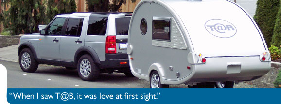

Postby bobhenry » Sun Dec 06, 2009 8:53 am
Stealth TDI wrote:Hello,
One point that's been just barely touched is frontal surface area. With the exception of braking and initial acceleration, I tend to believe a low, narrow 1000-lb trailer would tow better than a larger 500-lb trailer. This assumes the TV is a car. If it's a truck, then it's probably a wash. ;)
Scott
Head wind can be a problem too ! The barn does down the road fine behind my 2000 Suzuki esteem
UNTIL...
I was heading home 1 day in a 35 mph head wind . Now combine that with the 50 mph I was trying to maintain thats 85 mph. I was running out of ponys under the hood. So out of 5th and into 4th and all was well again.
"Aerodynamic as a barn"
You can build a 200# box and it will still require more h.p. to pull it if it is just a slab faced unit. I think the new roswell is one of the most aerodynamic shapes we have seen on this board in some time. Cargo trailers are opting for the Vee nose configeration. These are happening for a reason but it's not new , Len posted just today picture of a 1938 airstream larger tear. Round nose and a slopeing front roof for aerodynamics so maybe we should reconsider this configuration for a future build.
Thanks to Len ( I stole the pic)
I think I just found out where the T@B got it's rear design. Image
