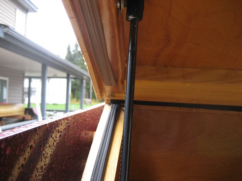

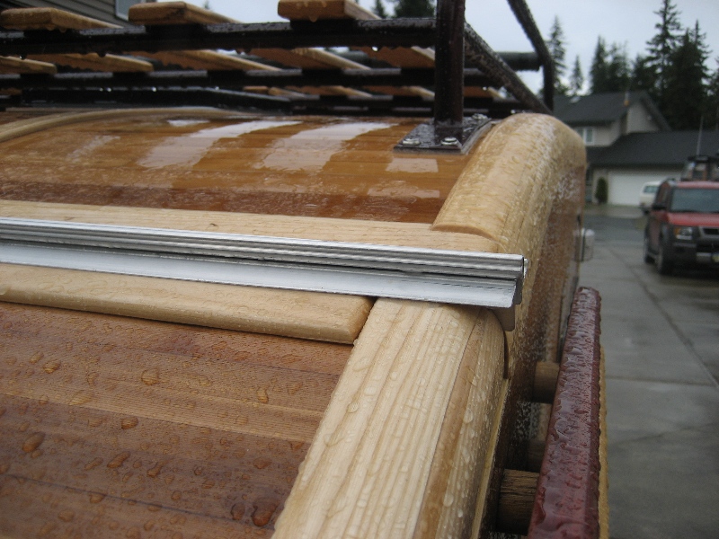

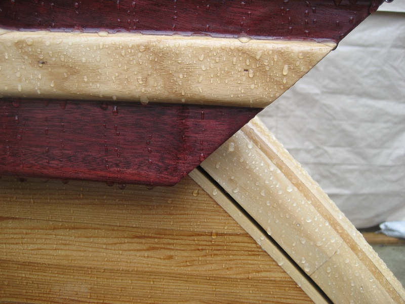

My hinges look a little goofy with the radius and battens, but I didnt have a better idea. BTW...this is year two with the auto clear coat over epoxy...
The hinge and battens act like a dam so relief cuts were added to let water drain, the hinge was glued in with 5200
The edge gap is pretty tight.
At first I used only the bottom gasket, but added the top for a tighter seal. Draw tight latches really seal it good....to the point the top gasket is deforming.

That looks great Dave, I would say the deformation of the top gasket is perfect, as it shows it cannot go anywhere but elsewhere.... and no water gets in.
My trailer may be stored indoors at the new house once we make it there when this one is sold etc, but chances ate that it will live outdoors, so a good seal is imperative.

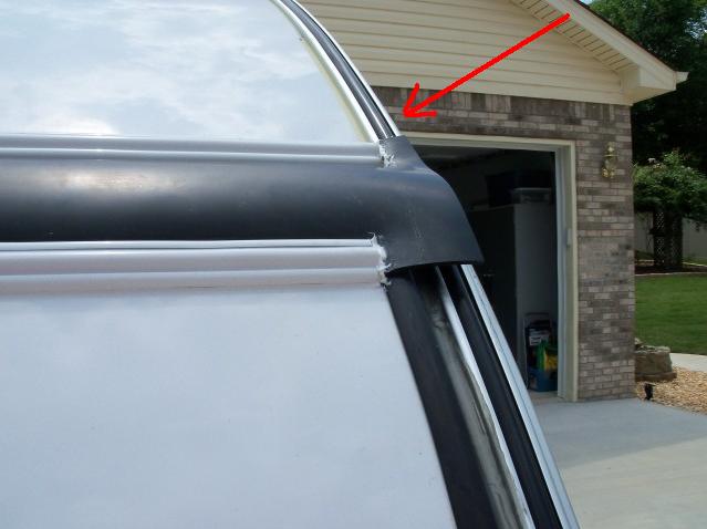

I have a T@B Clamshell which has had a leaking hatch from day 1. It went to the dealer under warranty umpteen times, had a new factory hatch put on and two different hinges put on and it still leaked a little bit. After seeing the pictures of Auntie M's rubber cover over her hatch, I hoped I had a solution!!
I didn't do the fix myself, took it to my dealer, but it turned out beautifully and doesn't leak anymore!!!!!!

I really like how your rubber hatch hinge cover was installed. I would like to see a better picture of the top edge and how the rubber is covered.
A picture from this angle:
I have never really liked any of the rubber covered hinge installations that I have seen on this forum, but yours looks very professional and neat.
