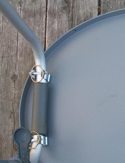

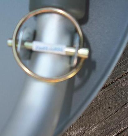

The 4 pipe clamps are bolted to the dish and when installed on the walker they go over the walker on either side of the right and left hand grip. This keeps the dish from sliding. I could have bolted the clamps solid on the walker handle but chose to simply pin them with a linch pin from the farm store. These are a little circle of spring steel with a small diameter pin. I simply insert the pin and flip the little circular spring around the pipe clamp and it is solid. I liked the linch pin idea for quick no tool breakdown for easy transport. The accessory shelf will simply rest on the lower leg bracket held from shifting side to side by 1x1 cleats while the shelf itsself will be made of 1x2's screwed to these cleats. I may have to get crazy and stain and finish it just for giggles.
Image linch pin

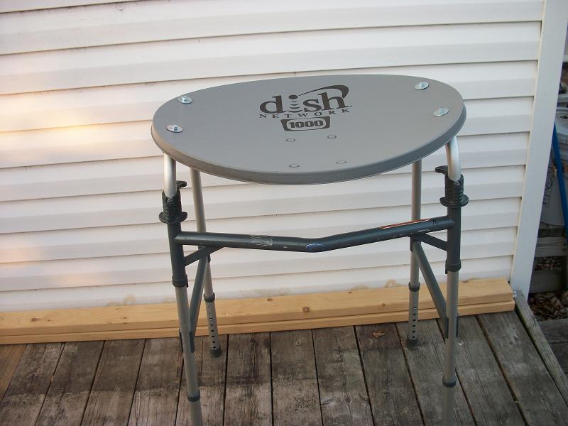

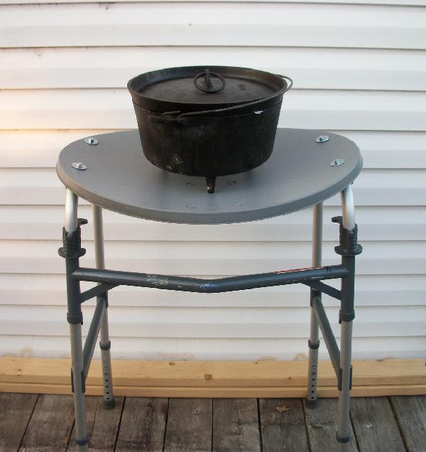

Postby bobhenry » Thu Nov 18, 2010 5:26 pm
HERE YA GO ......
Postby Cliffmeister2000 » Thu Nov 18, 2010 7:18 pm
I would cut off those rubber grips if I were you, they will surely melt...
Otherwise, that looks mighty fine! :thumbsup:

Postby bobhenry » Fri Nov 19, 2010 1:32 am
I am betting it won't get that hot that far out but we will see.

Postby Cliffmeister2000 » Fri Nov 19, 2010 7:26 am
My DO stand is a 3/16" piece of aluminum plate, that sits on my Camp Chef Expedition stove. I got it hot enough to warp the first time I used it!
It warped because I dumped a pile of coals there to use later. I guess a pile of coals can get pretty hot!
