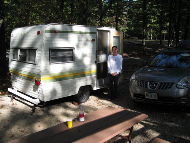

Postby petertl » Wed Nov 10, 2010 7:26 am
This is the TTT and the tow vehicle. I don't feel the car struggles greatly to pull on the highway, it doesn't fly up mountains or goes from 45 to 65 quickly.
It is not an ideal tow package, rated at 1000 lbs.
I do find it nice to get behind traffic to draft.
Thanks for everyone's input.
I would love to see people's home made spoilers!
Peter
