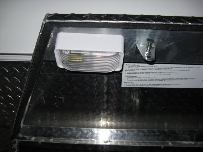

SonofT@B wrote: I put a 12v light in it along with my battery.
That is a snappy idea! I'm gaining inspiration* from that!
I did the same thing, it's very handy. I got my box from Northern Tool.
