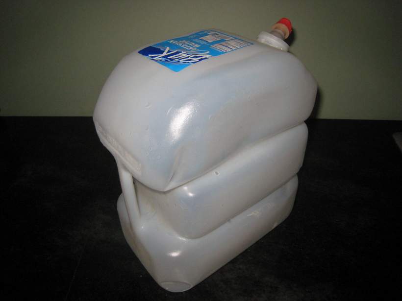

Were I to have to build one tomorrow, I'll build a super-Insulated version of the Krown Cooler. I'd envisioned any old Commercial Cooler of choice slipping down into a custom Thermax Box w/Lid. See one possible Container below that could be almost-filled and frozen with Water; Water and safe RV Antifreeze; or Salt Water.
This 2.5 Gallon Container could sit up horizontally to one side on L Brackets, just below the Lid, to effect the Krown Cooler idea. No drain req'd. Or, it could slide into vertical L Brackets in the Cooler center, and be held just up off the bottom. This would provide max cold surface area bilaterally while contacting water in the bottom to chill more efficiently. Cold pooled air would stratify in any case, and one can take advantage of that if ~1" of Water is objectionable. Note that Home Fridges de-stratify air with a Fan. The temp stratification 'problem' is noted in the Thread of last year.

We have a Commercial Cooler with a removable Container in the Lid we freeze. As the Krown Cooler establishes, Ice up 'high' is a great way to go. Super-insulation is what makes Space Station habitation possible where temps vary by hundreds of degrees, as well as making Antarctic Research Buildings habitable. Added to homebuilt Cooler design, significant performance advances like the Commercial Units linked above are affordable.
Isolate the inner Cooler environment via super-Insulation and then manage it by Food placement. Or not. :roll:
