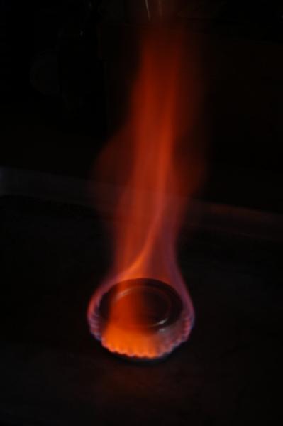

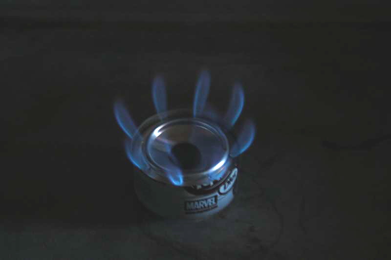

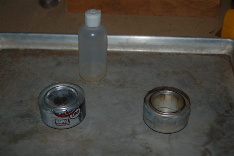

Postby Corwin C » Fri Dec 09, 2011 5:19 pm
As promised ... a few pictures ...
Just a couple from the collection ... they're so easy to make that I don't keep many laying around.
This one is similar to BigAl's ... bottom is inverted from his design. Flame just barely touches top edge of bottom can, vaporizing fuel inside can which pressurizes and creates the jets. This design won't quite make a rolling boil (at 6000' elevation), but it simmers well.
This is an entirely different design, open center, 34 jets around the outside, ring of aluminum from side of can to create "doughnut" shaped pressure chamber (no sealant, just cut out carefully.) Fill center with fuel just up to jet holes, light and as Mr.Cosby would say, "Now that's a fire!" Lack of oxygen in center keeps the flame on the outside. This will warm a can of soup in about 2 1/2 minutes. I simply set the open soup can (label removed to prevent ashes getting inside) right on the stove (it's a little tippy, be careful.) With a soup can on the stove the inefficient orange flame is replaced with the bright blue efficient flame right around the sides of the soup can.
Another safety note while I'm thinking about it. I burn regular hardware store denatured alcohol as fuel and it is ALMOST invisible in all but dim light (one reason for the dark fuzzy pictures.) Please be careful. It's pretty easy to un-intentionally start something on fire and not know it.
