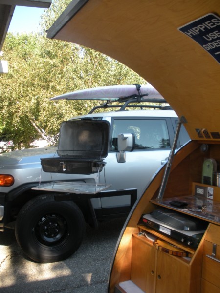

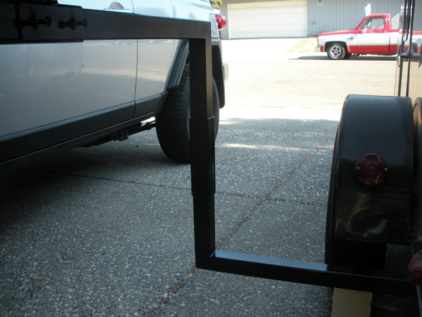

We have several tables that attach to our trailer using a receiver welded underneath. We are fortunate to have a good friend who is a welding genius that can take my drawings and make them functional. This is a picture of our latest creation.

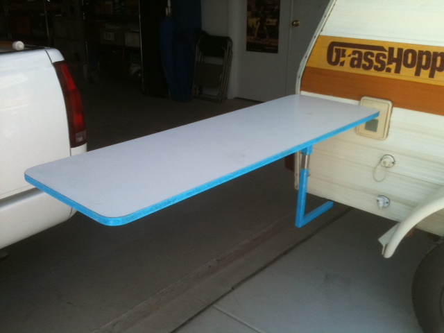

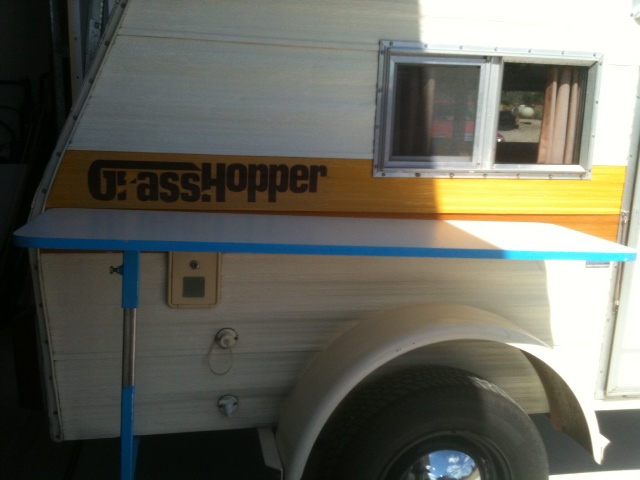

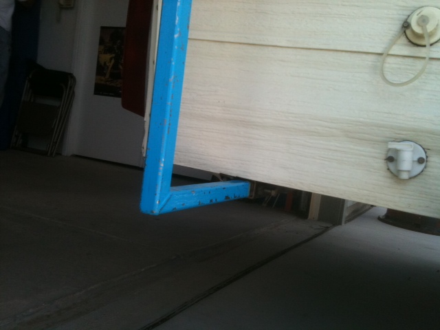

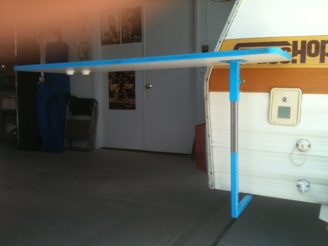

Here it the table that fits my tear...I have a different one that is not blue, but it's the same design. The table is one piece, the 'leg' is another, and the leg slides into the mount welded underneath the trailer to the frame. The table can be mounted 3 ways, as shown.

Wow! That is a great side table. Good size and flexibility.
