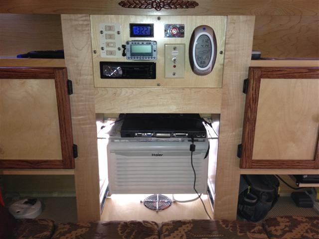

Here's an inside shot of the AC in use, I have a little fan underneath it to circulate air to it:

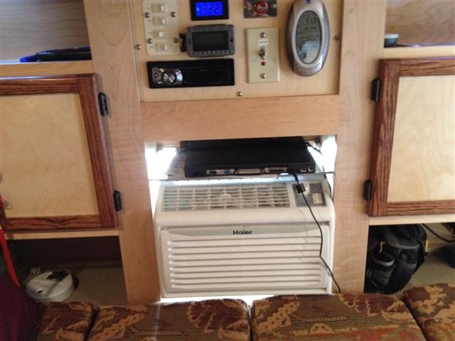

Here's the interior view of it in travel position, it slides in and out using drawer slides. It was kind of a PITA to get the slides installed and adjusted. I also measured a dozen times as well as mocked it up with scrap to make sure the cubby hole was the right size. I used a screen door latch to keep it from moving when in transit or it pushes against the door. I couldn't figure out why the hatch latches kept getting bent the first few trips out. I think it would slam right through the door if I ever hit something and it wasn't secured.:

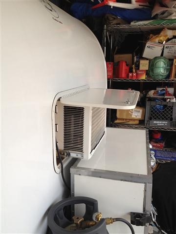

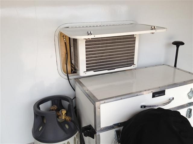

Here an exterior view of the AC in use. The hatch also is a nifty place for the satellite connection. I can close the hatch over the wire when its cold or wet outside. And yes, I have to push the AC back in when I need to get to the tongue box. I built the tongue box early in the build before I measured where the AC could fit. I was lucky to get everything there to fit.
The AC doesn't really stick out that far and I've never had a problem with it dripping inside the trailer. I didn't use any weather seal on the AC, believe it or not the cargo door keeps most of the rain out. The AC was a $79 end-of-season special from Home Depot.

Bruce,
Thanks you so much for the pictures. That is just what I needed to see.
Good information I hadn't thought of--securing the AC on its slides.
And now that I think about the slight space around the AC and the opening, It might be a good thing
to have a little outside ventilation that is there only when using the AC, to keep the evaporator from
frosting up. I like the shape of that little unit with the evap "cool out" more on the top. And the fact that it seems to run
fine with only a half protruding instead of 3/4 or more. I think, like you said, my difficulty will be getting the enclosure exactly the right width to accomodate the slides and the AC. I recently redid the slides and frame for a bathroom drawer at least a half a dozen times--I couldn't seem to get the slides parallel and the drawer would slide in part of the way and then bind because the width was too tight, and then I overcompensated and it would bind because the width increased. But in the end I prevailed. Like I have mentioned before, I experience a lot of error in my trial and error.
I am extremely encouraged to see the simplicity of the set-up and hear that it works well.
