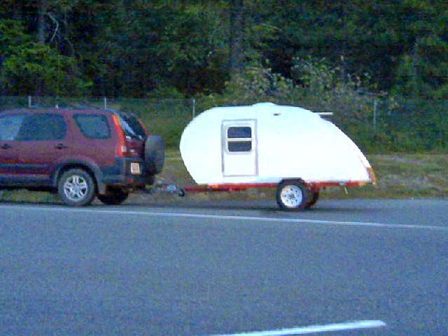

I saw this at the Indian john hill rest area a week ago
the Honda CRV is All Honda civic drive train , I did not see the owner around so I did not get to talk to them :NC
